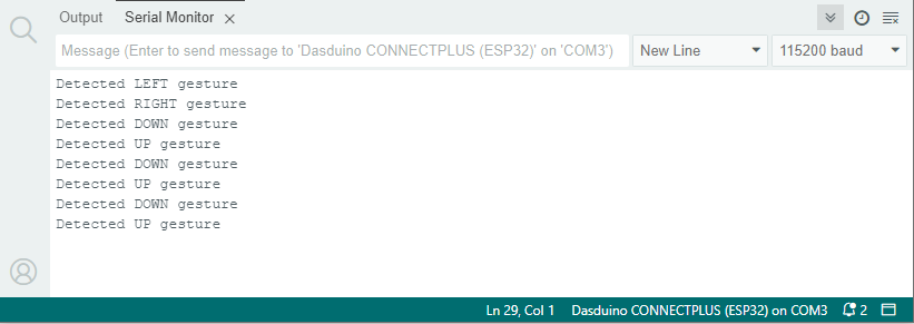

Serial Monitor
Gesture Detection Serial Monitor output
