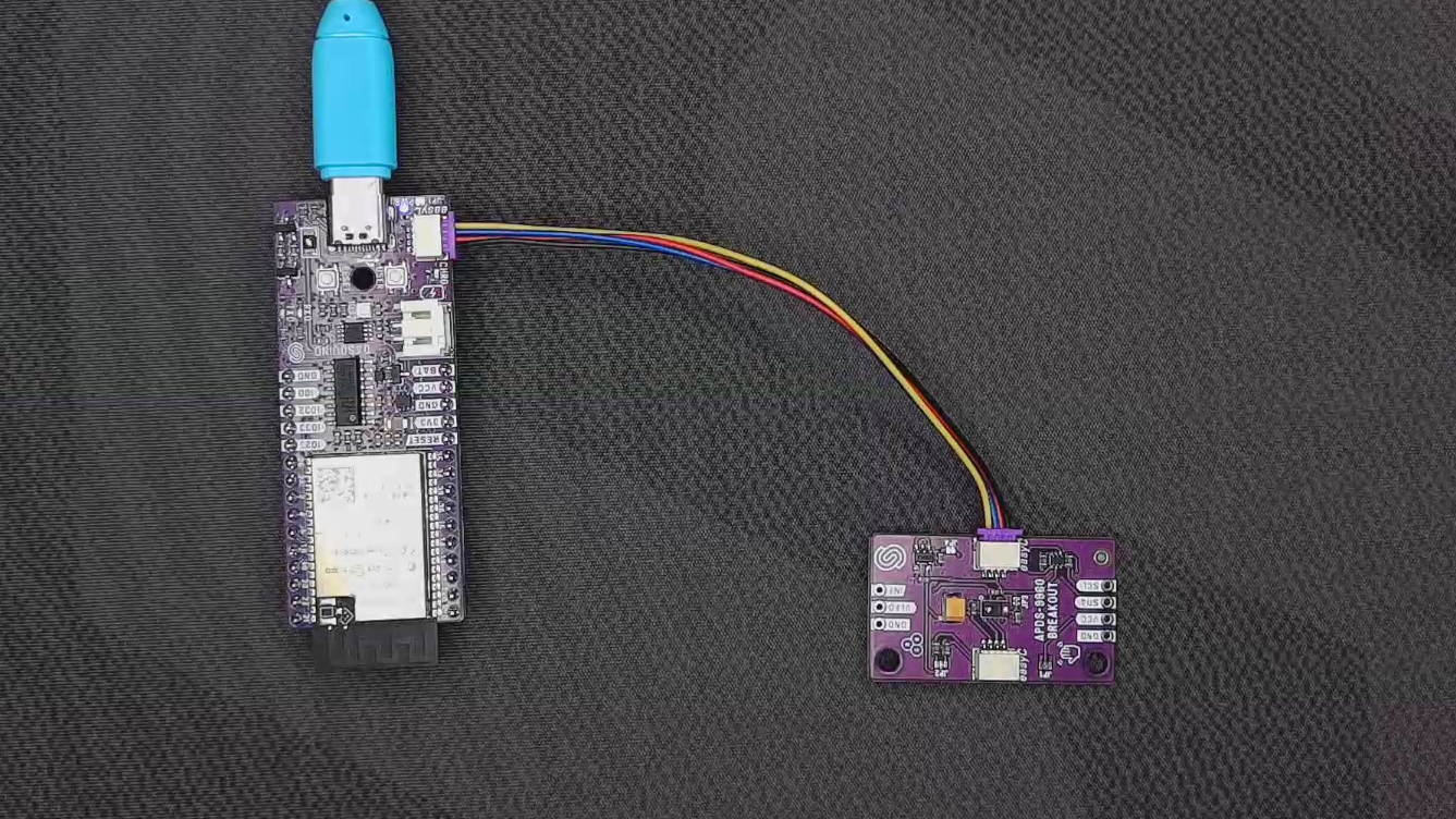

This page contains simple examples of initialization and proximity detection with the APDS-9960 sensor.
Proximity Sensor​

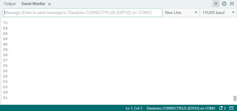

When reading open-air proximity, the sensor reaches the maximum value of 255.
Serial Monitor
Serial Monitor
Proximity Sensor Serial Monitor output
Serial Monitor
Serial Monitor
