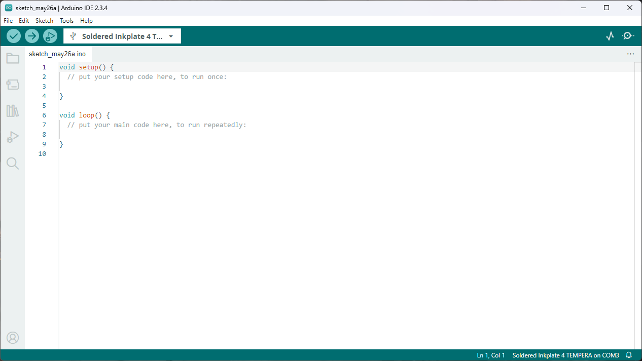

1. Install Arduino IDE​
If you haven't installed it yet, download and install the Arduino IDE from the official website.
Arduino IDE 2.0 or newer is required for Inkplate 4TEMPERA.
Install Arduino IDE
Arduino IDE 2.0

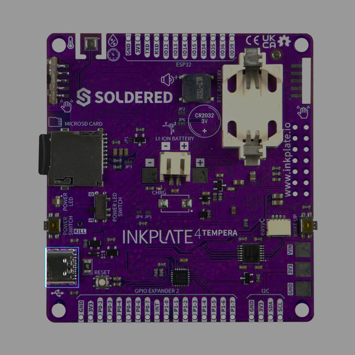

1. Connect Inkplate via USB and power it on​

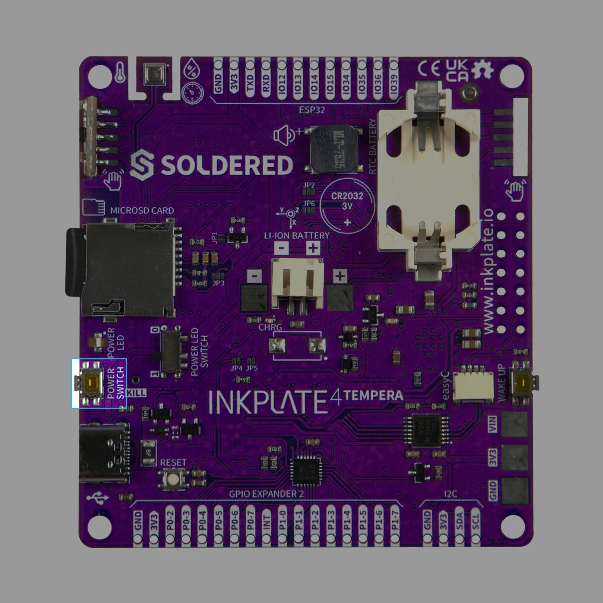

Use the provided USB-C cable to connect Inkplate 4TEMPERA to your computer. Ensure that the board is powered on by pressing the POWER ON button. The blue power LED will light up when properly connected.
Inkplate 4TEMPERA onboard USB-C connector
Inkplate 4TEMPERA onboard POWER button

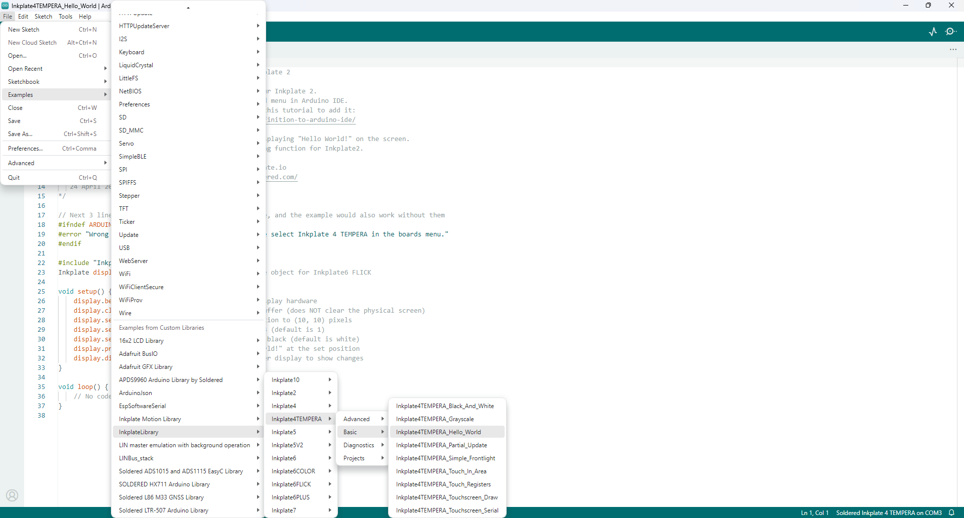

2. Create a sketch​
For the purposes of this documentation, we will use a pre-made example. Go to
File->Examples->InkplateLibrary->Inkplate4TEMPERA->Basic->Inkplate4TEMPERA_Hello_World
Selecting a basic example for Inkplate 4TEMPERA

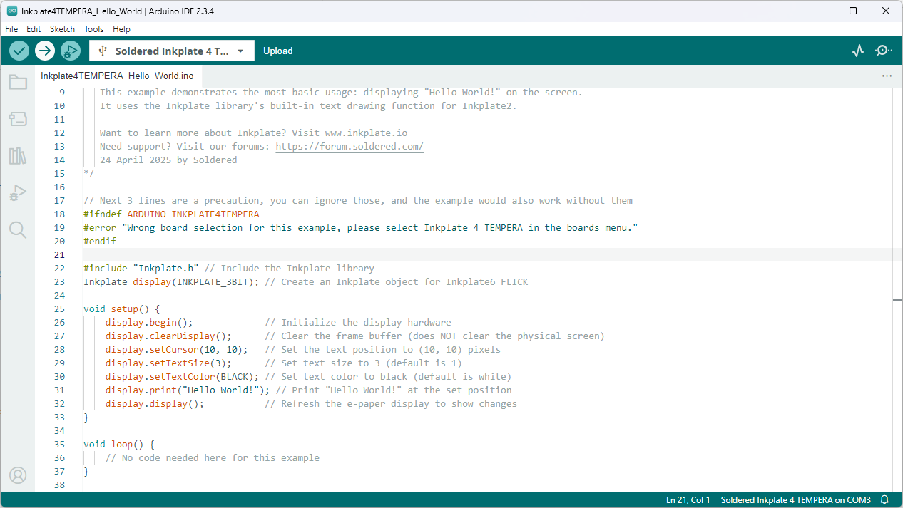

3. Upload the code​
Before uploading the code, select the correct board definition. The table below should help you out:
Board DefinitionBoard Description
Soldered Inkplate 4TEMPERASelect this board definition to upload code to Inkplate 4TEMPERA.
Click Upload in the Arduino IDE.
Arduino IDE Upload Button
Once the process completes, Inkplate will restart automatically and run the newly uploaded code. Arduino's upload log should read:
Leaving...
Hard resetting via RTS pin...
