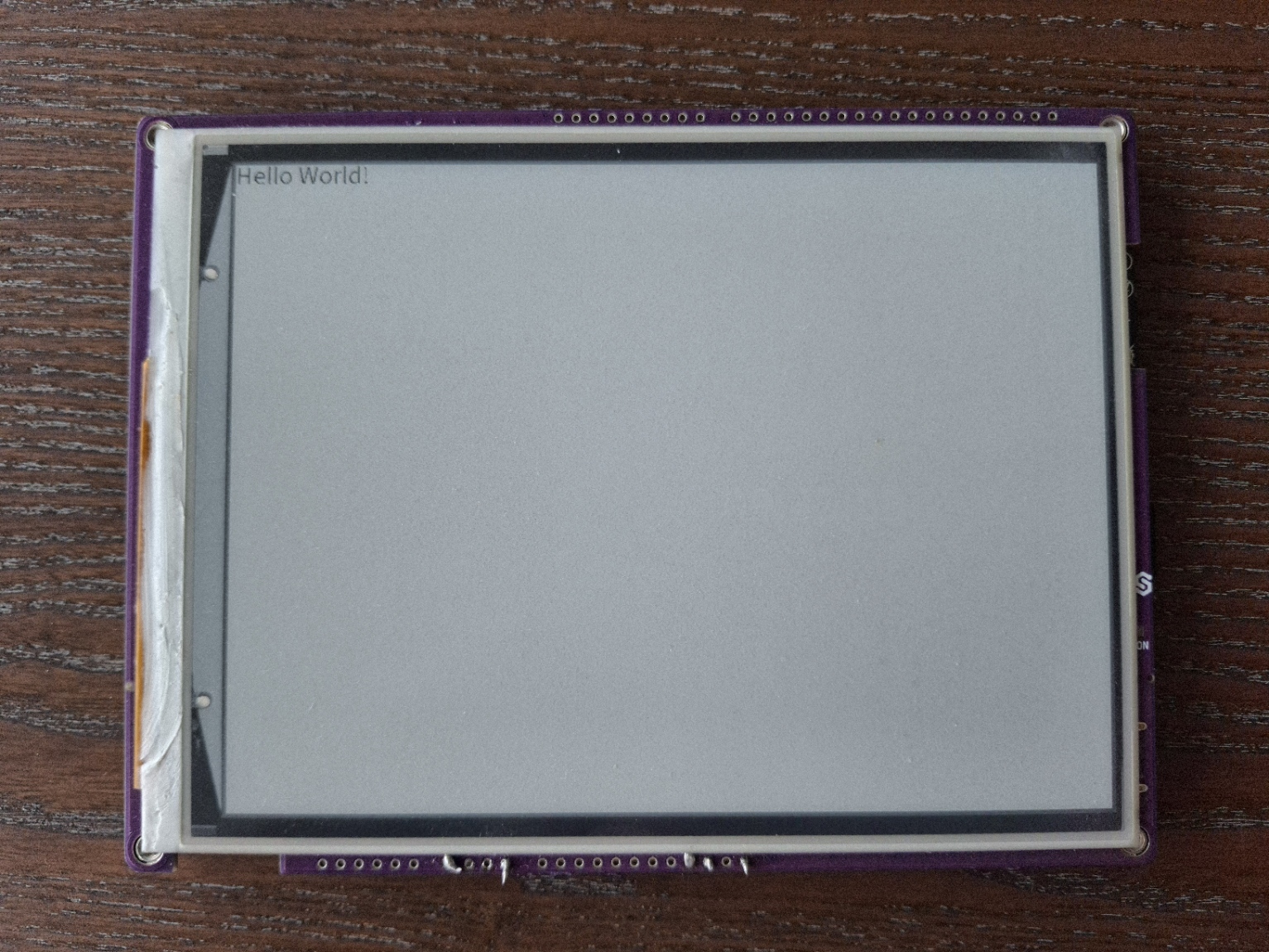

Here is the shortest way to get text onto the display.
from inkplate6 import Inkplate # Include the Inkplate module
inkplate = Inkplate(Inkplate.INKPLATE_2BIT) # Create a display instance (8-level grayscale)
inkplate.begin() # Initialize the display
inkplate.set_text_size(2) # Scale up the font size
inkplate.set_cursor(250, 250) # Set the cursor from where the text will be written
inkplate.print("Hello world!") # Print to the display buffer
inkplate.display() # Display what is drawn to the buffer
inkplate.print()
Puts the text in display buffer at the current position on display
Function parameters:
TypeNameDescription
StringtextString to render.
Inkplate 6 running the example code
Displaying basic information

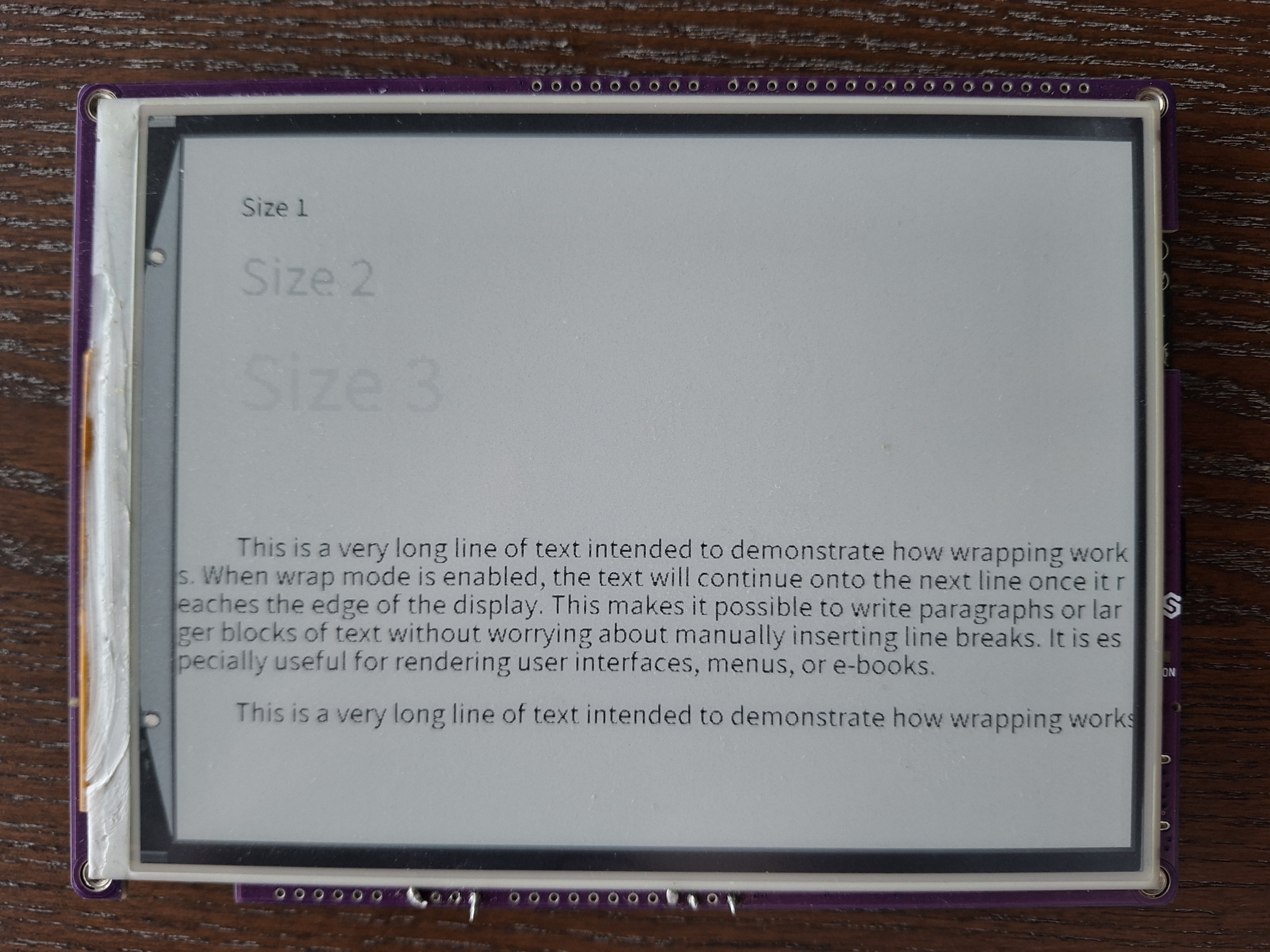

Displaying text in grayscale and more text parameters​
Inkplate 6 also lets you render grayscale graphics on its canvas, using 8 shades from 0 to 7. You can also modify different text parameters, such as: text color, text size and text wrapping. Below is a simple example demonstrating different text colors using grayscale and different text styles:
The grayscale mode enum is still named INKPLATE_2BIT for backwards compatibility, but the panel is driven with the full 8-level (3-bit) waveform.
Color parameter in 'set_text_color()' changes text color as per table below:
VALUECOLOR
0Black
1-3Dark greys
4-6Light greys
7White
import time
# Create Inkplate object in grayscale mode (8 shades, 0-7)
inkplate.begin()
# Clear the frame buffer
inkplate.clear_display()
inkplate.display()
inkplate.set_cursor(50, 50)
inkplate.set_text_size(1)
inkplate.set_text_color(0) # black
inkplate.print("Size 1")
inkplate.set_cursor(50, 100)
inkplate.set_text_color(1) # dark gray
inkplate.print("Size 2")
inkplate.set_cursor(50, 180)
inkplate.set_text_size(3)
inkplate.set_text_color(5) # light gray
inkplate.print("Size 3")
long_text = (
"This is a very long line of text intended to demonstrate how wrapping works. "
"When wrap mode is enabled, the text will continue onto the next line once it "
"reaches the edge of the display. This makes it possible to write paragraphs "
"or larger blocks of text without worrying about manually inserting line breaks. "
"It is especially useful for rendering user interfaces, menus, or e-books."
inkplate.set_cursor(50, 340)
inkplate.set_text_wrapping(True)
inkplate.print(long_text)
inkplate.set_cursor(50, 480)
inkplate.set_text_wrapping(False)
inkplate.display()
Simple grayscale example with different text styles.
