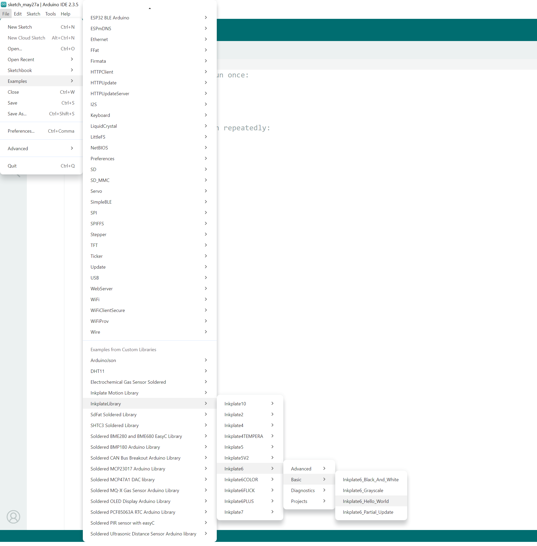

2. Create a sketch​
For this documentation, we will use a pre-made example. Go to File->Examples->InkplateLibrary->Inkplate6->Basic->Inkplate6_Hello_World.
Selecting a basic example for Inkplate 6

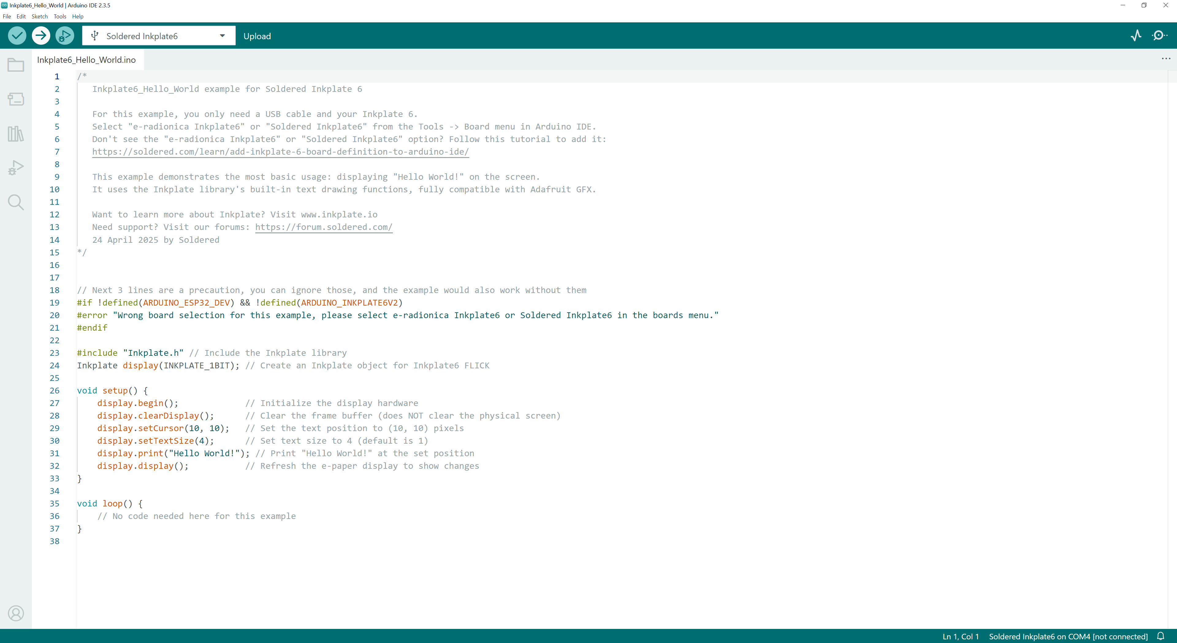

3. Upload the code​
Click Upload in the Arduino IDE.
Arduino IDE Upload Button
Once the process completes, Inkplate will restart automatically and run the newly uploaded code. Arduino's upload log should read:
Leaving...
Hard resetting via RTS pin...
