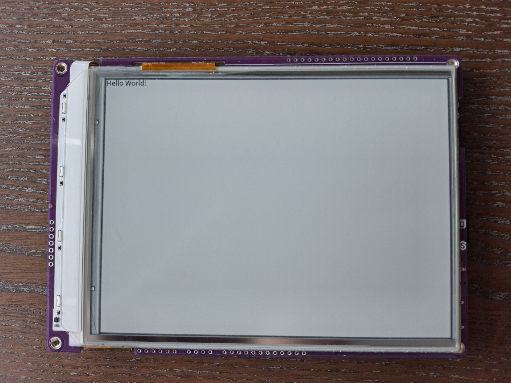

Inkplate 6FLICK allows you to print text on a 1024 x 758 px canvas.
Displaying basic information​
Below is a simple example demonstrating the simple way of displaying the information on the Inkplate display.
from inkplate6_flick import Inkplate # Include the Inkplate module
inkplate = Inkplate(Inkplate.INKPLATE_1BIT) # Create a display instance (8-level grayscale)
inkplate.begin() # Initialize the display
inkplate.set_text_size(2) # Scale up the font size
inkplate.set_cursor(380, 350) # Set the cursor from where the text will be written
inkplate.print("Hello world!") # Print to the display buffer
inkplate.display() # Display what is drawn to the buffer
inkplate.print()
Puts the text in display buffer at the current position on display
Function parameters:
TypeNameDescription
StringtextString to render.
Inkplate 6FLICK running the example code

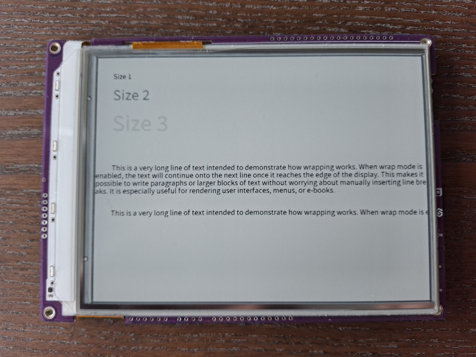

Displaying text in Grayscale and more text parameters​
Inkplate 6FLICK also lets you render 2-bit grayscale graphics (0-3) on its canvas. You can also modify different text parameters, such as: text color, text size and text wrapping. Below is a simple example demonstrating different text colors using grayscale and different text styles:
Color parameter in 'set_text_color()' changes text color as per table below:
VALUECOLOR
0Black
1Dark grey
2Dark grey
3White
import time
# Create Inkplate object in 2-bit grayscale mode
inkplate = Inkplate(Inkplate.INKPLATE_2BIT)
inkplate.begin()
# Clear the frame buffer
inkplate.clear_display()
inkplate.display()
inkplate.set_cursor(50, 50)
inkplate.set_text_size(1)
inkplate.set_text_color(0) # black
inkplate.print("Size 1")
inkplate.set_cursor(50, 100)
inkplate.set_text_color(1) # dark gray
inkplate.print("Size 2")
inkplate.set_cursor(50, 180)
inkplate.set_text_size(3)
inkplate.set_text_color(2) # light gray
inkplate.print("Size 3")
long_text = (
"This is a very long line of text intended to demonstrate how wrapping works. "
"When wrap mode is enabled, the text will continue onto the next line once it "
"reaches the edge of the display. This makes it possible to write paragraphs "
"or larger blocks of text without worrying about manually inserting line breaks. "
"It is especially useful for rendering user interfaces, menus, or e-books."
inkplate.set_cursor(50, 340)
inkplate.set_text_wrapping(True)
inkplate.print(long_text)
inkplate.set_cursor(50, 480)
inkplate.set_text_wrapping(False)
inkplate.display()
inkplate.set_cursor()
Set the cursor position for the next text to be rendered.
TypeNameDescription
NumberxX coordinate for the text start.
NumberyY coordinate for the text baseline.
inkplate.set_text_size()
Set the text size scaling factor.
TypeNameDescription
NumbersizeScale factor (1 = normal, 2 = double, 3 = triple, …).
Set the text color (grayscale level) used for text rendering.
TypeNameDescription
NumbercolorGrayscale value for text (0 = white to 3 = black in 2-bit mode).
inkplate.set_text_wrapping()
Enable or disable automatic text wrapping when reaching the display edge.
Returns value: Nothing
TypeNameDescription
BooleanwrapTrue to wrap text, False to let it continue off-screen.
Simple grayscale example with different text styles.
