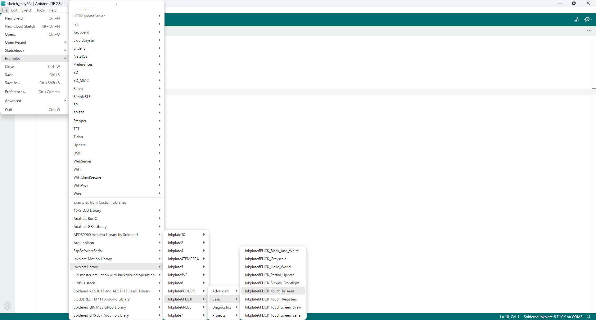

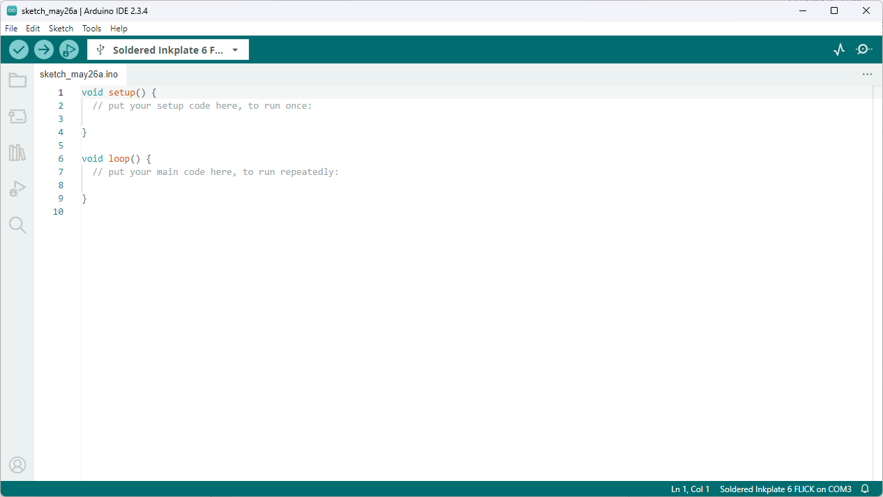

2. Create a sketch​
For the purposes of this documentation, we will use a pre-made example. Go to
File->Examples->InkplateLibrary->Inkplate6FLICK->Basic->Inkplate6FLICK_Hello_World
Selecting a basic example for Inkplate 6FLICK

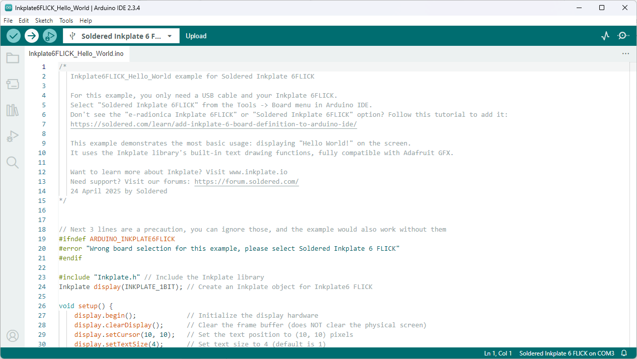

3. Upload the code​
Before uploading the code, select Soldered Inkplate 6FLICK as the board definition. It's the only one for this board, since Inkplate 6FLICK came out after the switch to the Soldered brand.
Click Upload in the Arduino IDE.
Arduino IDE Upload Button
Once the process completes, Inkplate will restart automatically and run the newly uploaded code. Arduino's upload log should read:
Leaving...
Hard resetting via RTS pin...
