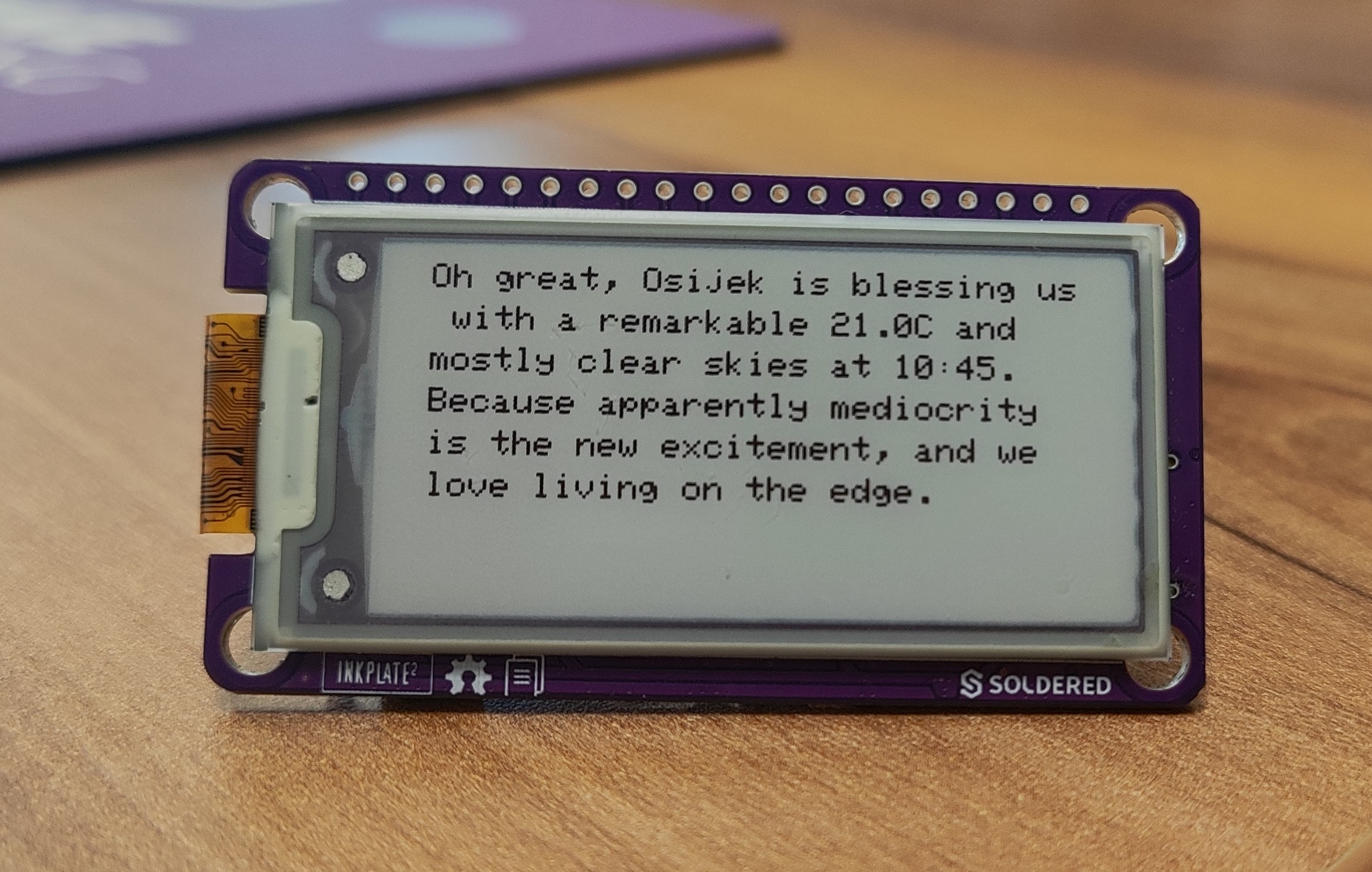

The OpenAI Text Prompt Generator project is a playful and intelligent weather display that combines live data from the Open-Meteo API with witty text generated by OpenAI. Designed to run entirely on the Inkplate's low-power e-paper hardware, this sketch fetches current weather conditions for your chosen location and then uses that information to craft a sarcastic, snarky one-liner summary—perfect for adding personality to your desk or wall display.
Once connected to Wi-Fi, the device queries the temperature, sky condition, and local time, then sends a cleverly composed prompt to OpenAI’s chat API. The resulting humorous weather quip is rendered on the Inkplate screen using a bold, legible font. Thanks to the energy-efficient design and e-paper technology, the display remains readable without constant power, and the device enters deep sleep between updates to conserve battery life.

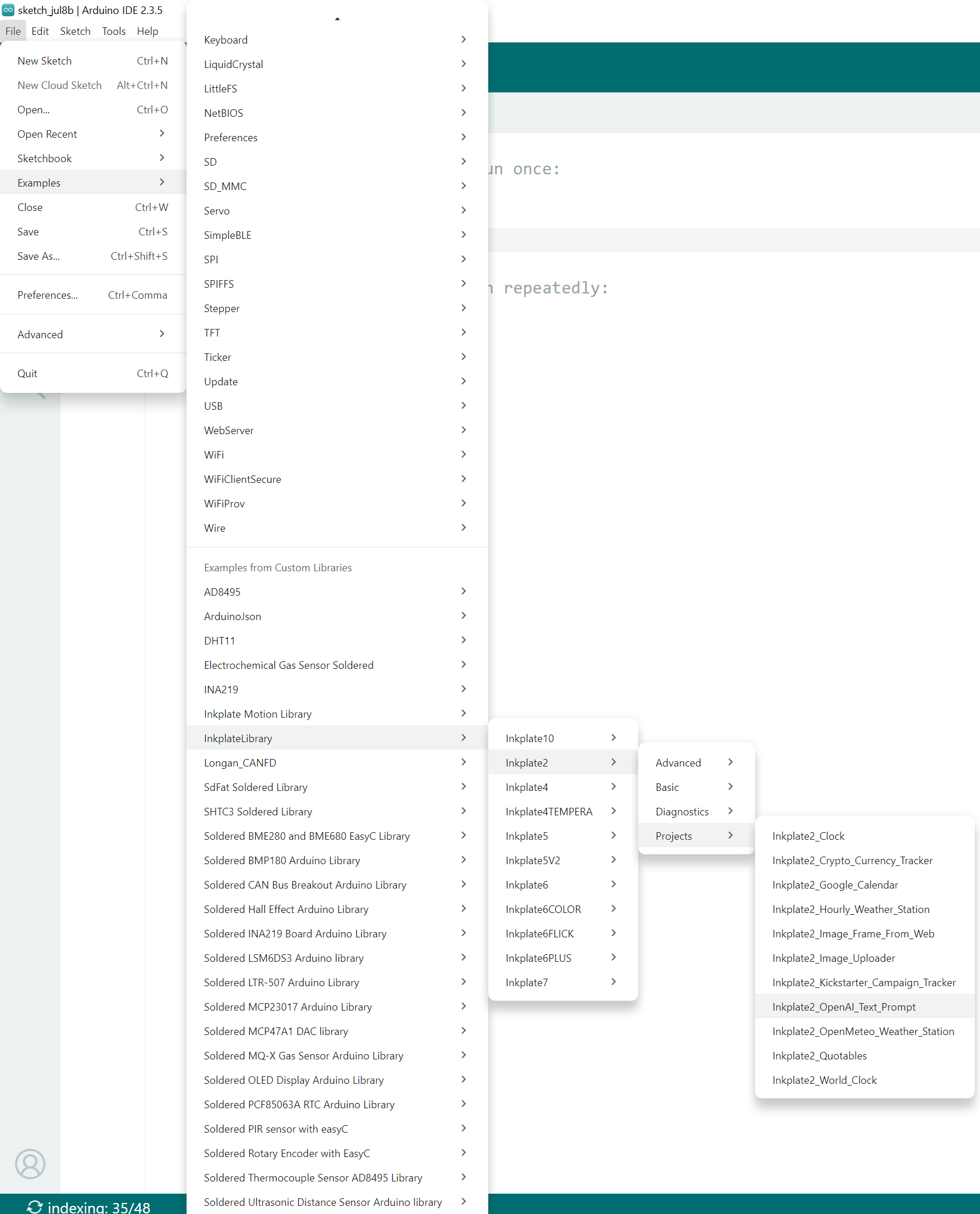

The Arduino sketch must be modified for this project to run. First, open the Arduino IDE and navigate to
File->Examples->InkplateLibrary->Your Inkplate Device->Projects->Inkplate_OpenAI_Text_Prompt:
Arduino sketch path directions

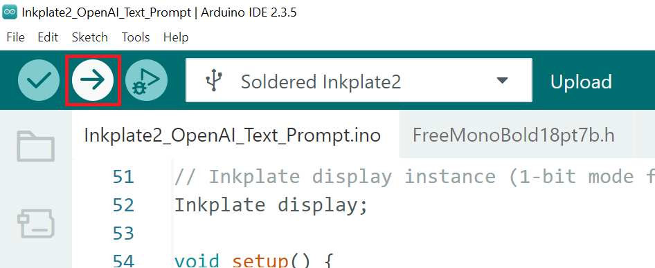

Uploading the code​
After completing all the previous steps, uploading the project to the Inkplate is as simple as pressing the upload button in the Arduino IDE:
Arduino upload button
If you are having trouble uploading the code, check out our in-depth upload tutorial:
Quick start guide
A full, comprehensive tutorial on how to fully set up and upload code to the Inkplate for the first time
