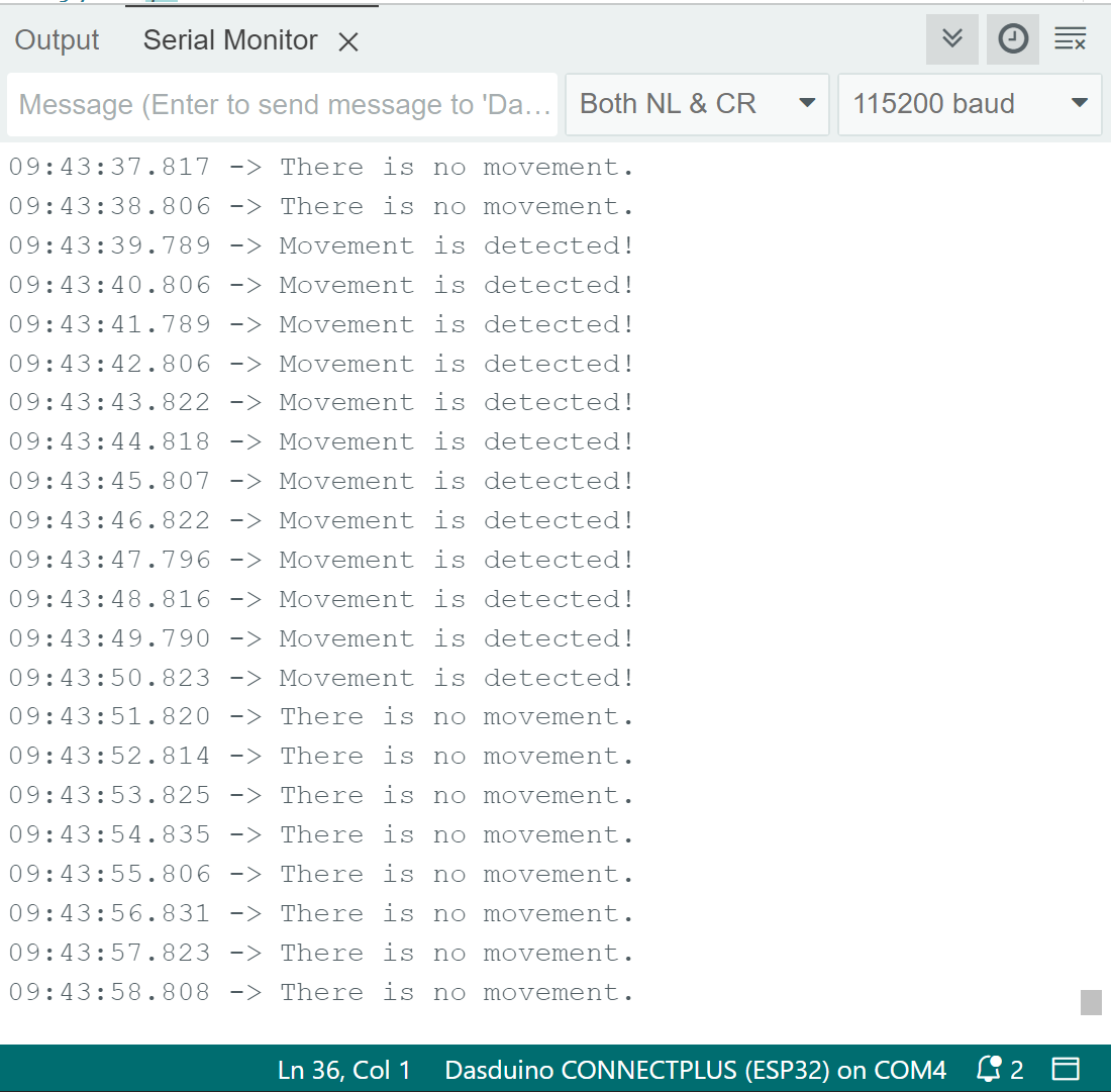

Detecting movement​
Next, in the loop() function we check if the PIR sensor is available for communication. If it is, we see if there is movement or not and print the state to the serial monitor:
// Check if the PIR is available
if (PIR.available())
if (PIR.getState() == 1) // If movement is detected
Serial.println("Movement is detected!");
else // If no movement is detected
Serial.println("There is no movement.");
else // Error reading I2C data
Serial.println(
"There is no data to read. Check if your sensor is connected or if you used the wrong I2C address.");
delay(1000); // Delay 1 second before next reading
Motion detection on serial monitor
