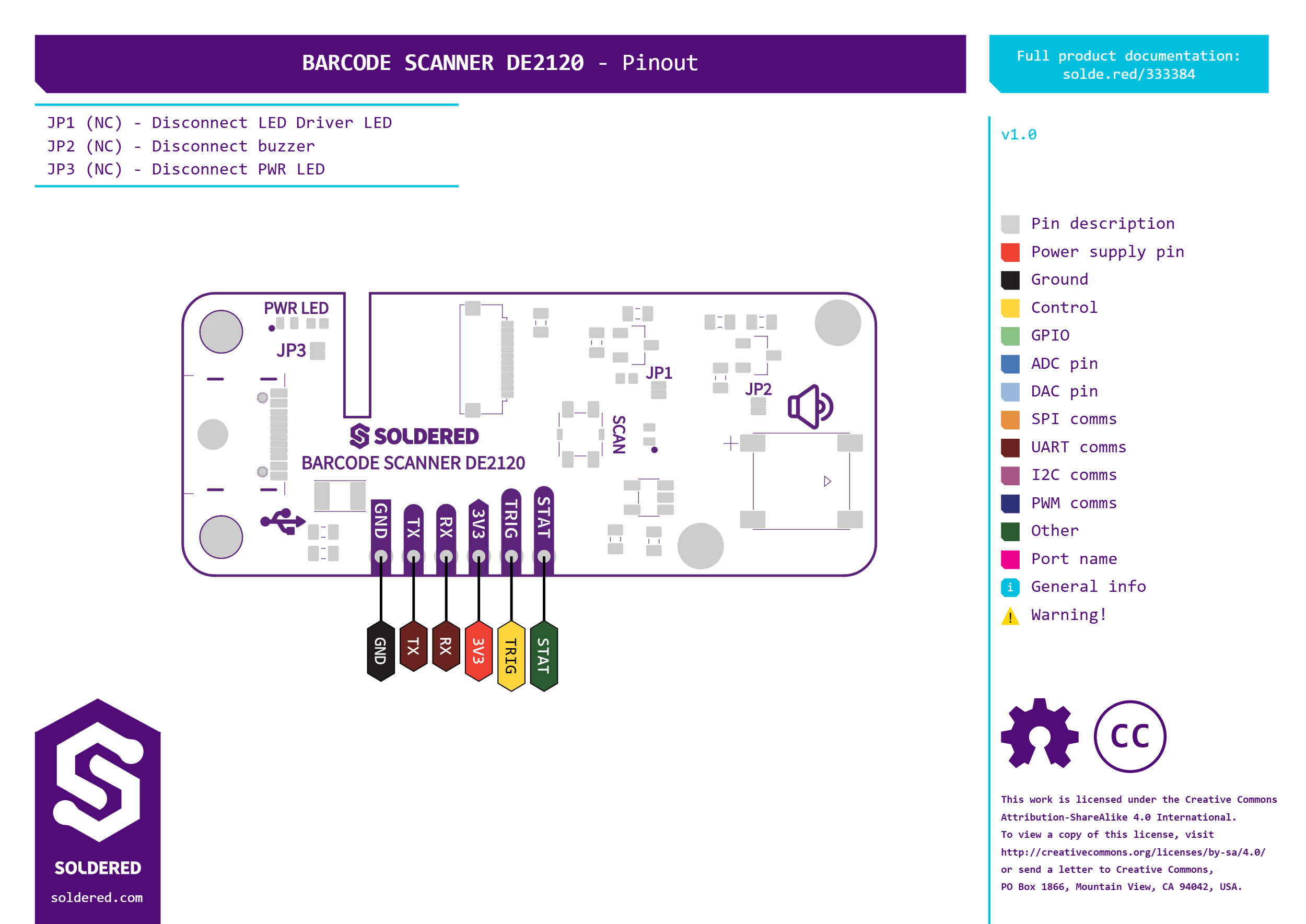

Pinout​
DE2120 Barcode Scanner Pinout
Pin details​
STATStatus OutputActive-low decode status output from the scanner. Pulled low on each successful barcode decode. Also drives the onboard blue status LED. Connect to any MCU GPIO to detect scans in hardware.
TRIGTrigger InputActive-low hardware scan trigger. Pull low to start a scan in manual mode. Also connected to the onboard trigger button (SW1).
3V3Power3.3 V power rail. Outputs regulated 3.3 V when the board is powered from USB-C. Supply 3.3 V here when powering externally without USB-C.
RXUART RXSerial data input from microcontroller to scanner. Connect to MCU TX pin.
TXUART TXSerial data output from scanner to microcontroller. Connect to MCU RX pin.
GNDGNDGround reference for power and signals.

Jumper Details​
Loading carousel...
JumperDefault StateFunction
JP1NC (Normally Closed)Enables the blue STAT LED (D3). When closed (default), the LED lights on each successful barcode decode. Cut to disable the status LED.
JP2NC (Normally Closed)Enables the onboard buzzer (U2). When closed (default), the buzzer sounds on each successful decode. Cut to silence the buzzer.
JP3NC (Normally Closed)Enables the purple power LED (D2). When closed (default), the LED is lit whenever the board has power. Cut to disable the power indicator.
