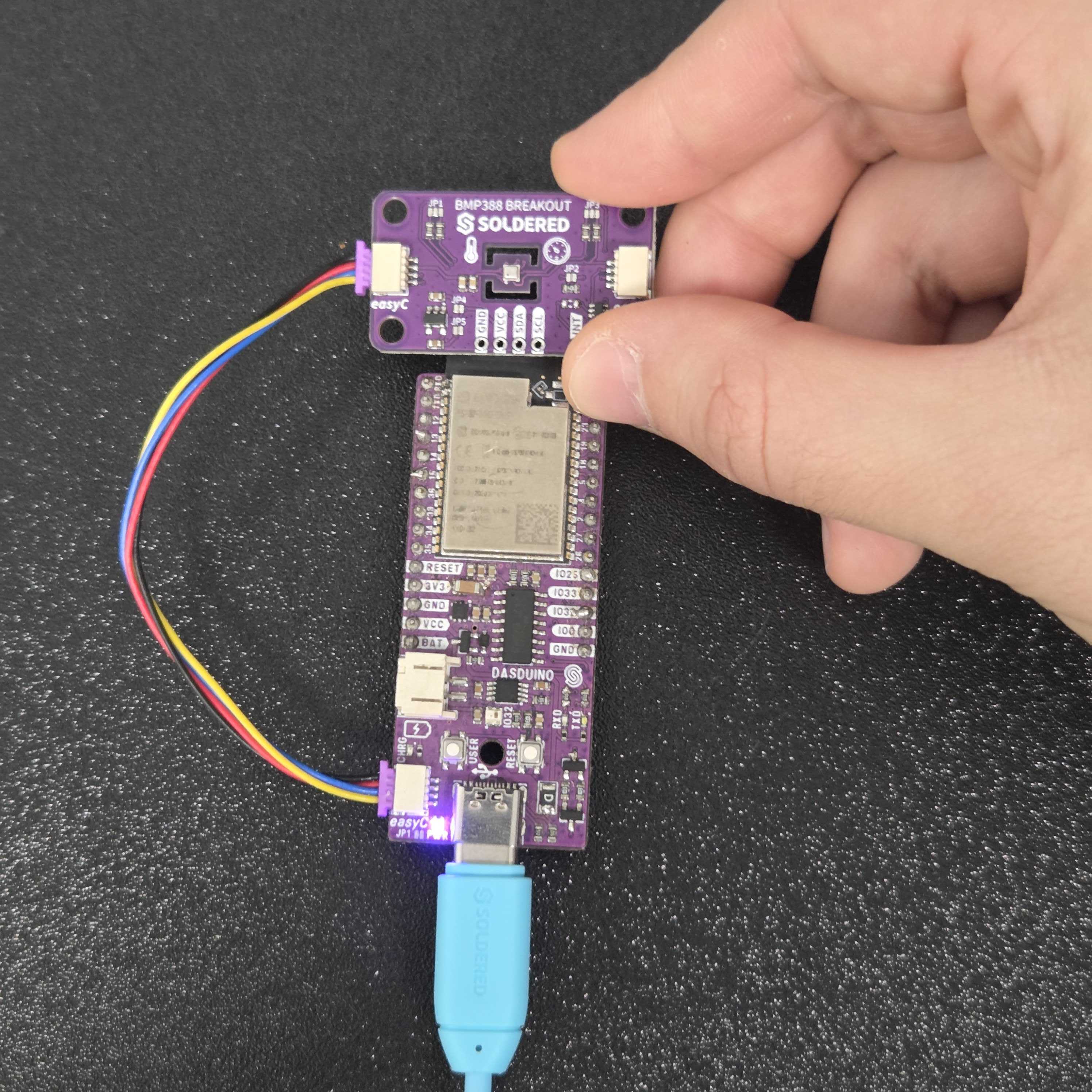

Connections for this example​
Connections

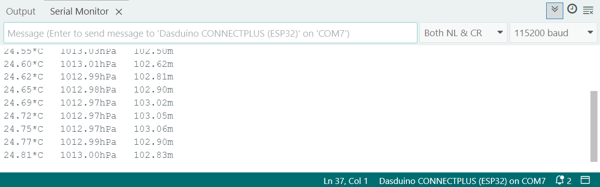

Serial monitor readings
Serial monitor
