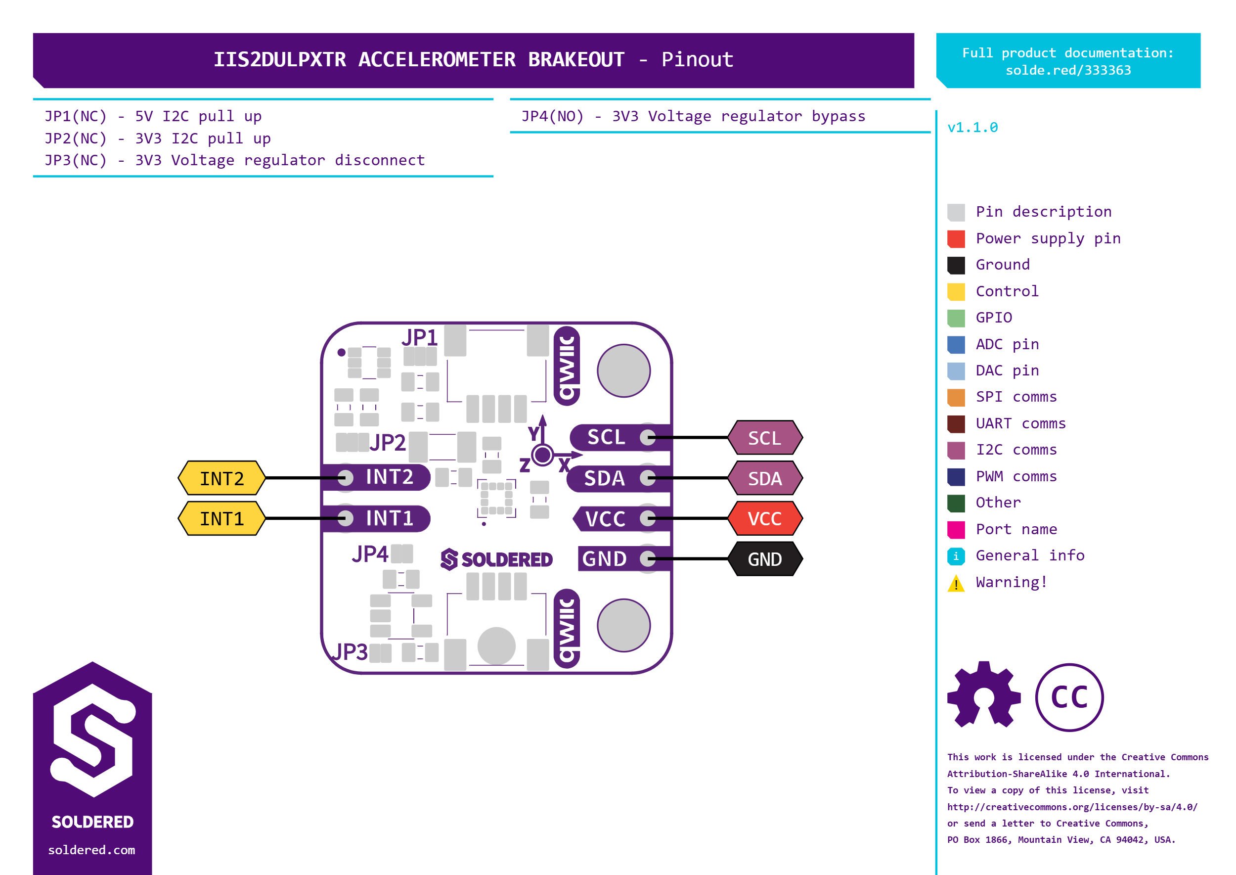

Pinout​
IIS2DULPX Accelerometer breakout pinout
Pin details​
VCCPowerSupply voltage (both 5V and 3.3V are supported).
INT1InterruptProgrammable interrupt output 1.
INT2InterruptProgrammable interrupt output 2.
This breakout board operates on supply voltages of 3.3V and 5V thanks to the onboard voltage regulator.
