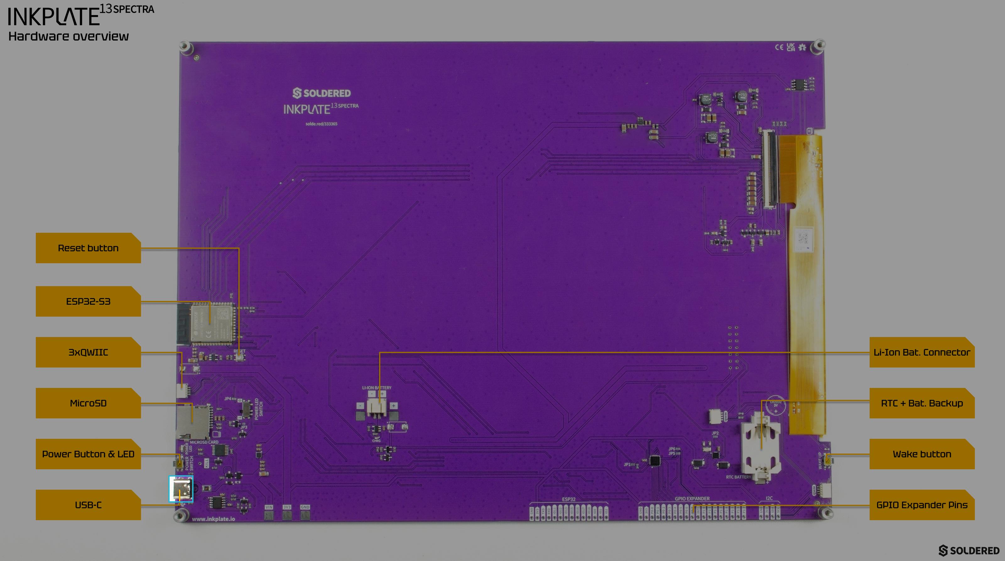

1. Connect Inkplate via USB and power it on​
Use the provided USB-C cable to connect Inkplate 13SPECTRA to your computer.
USB-C connector highlighted on Inkplate 13SPECTRA
USB-C connector

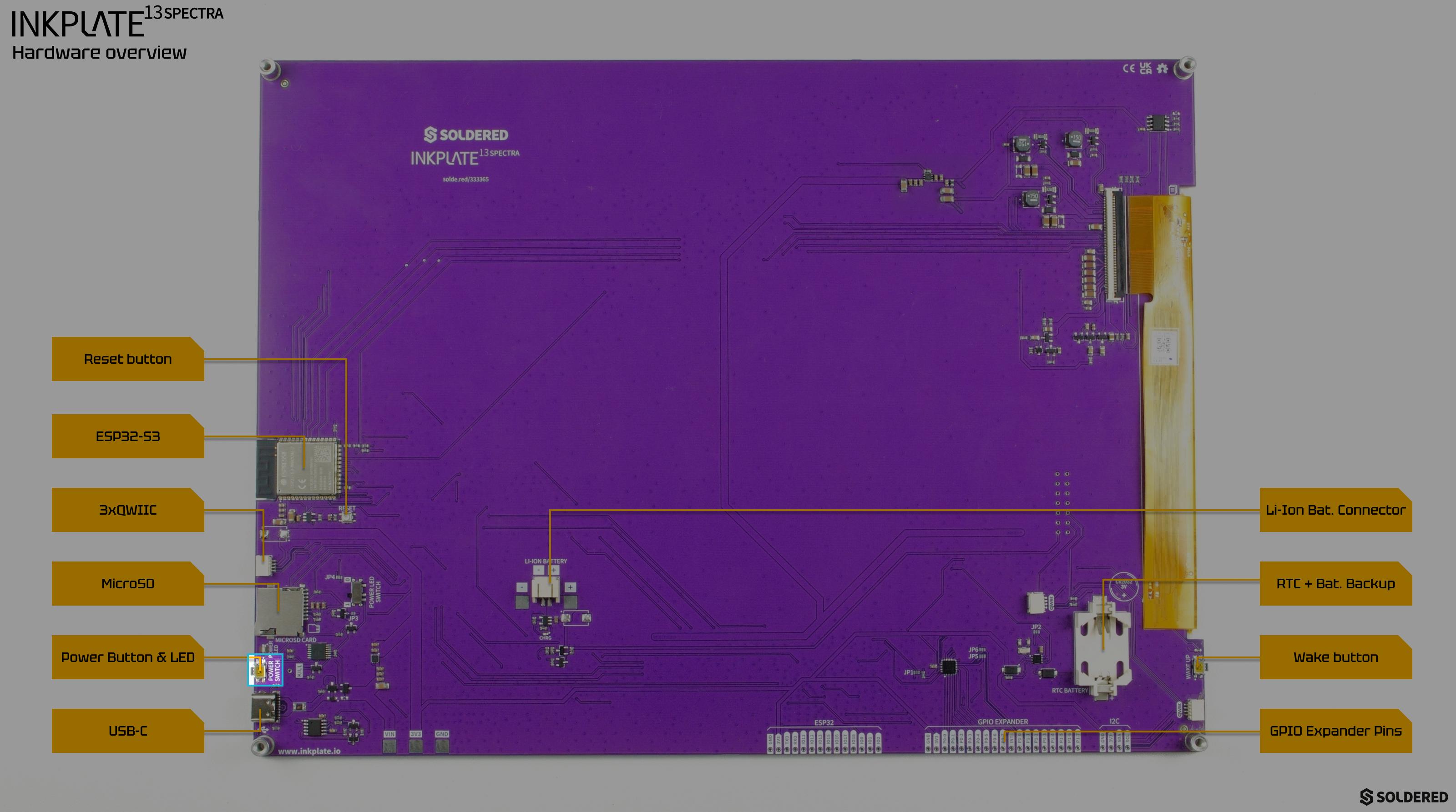

Ensure that the board is powered on by pressing the POWER ON button. The blue power LED will light up when properly connected.
Power switch highlighted on Inkplate 13SPECTRA
Power switch

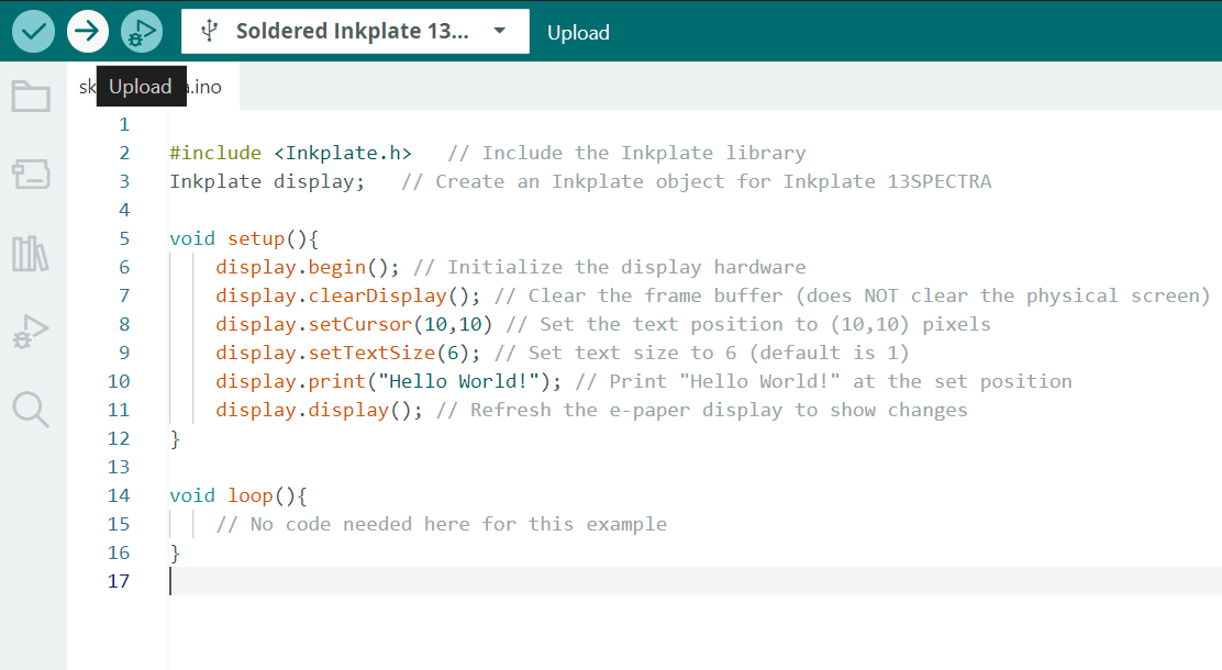

2. Create a sketch​
Let's create the most basic Inkplate code which writes Hello World! to the e-Paper display. Go to File->New Sketch and paste this code in:
#include <Inkplate.h> // Include the Inkplate library
Inkplate display; // Create an Inkplate object for Inkplate 13SPECTRA
void setup(){
display.begin(); // Initialize the display hardware
display.clearDisplay(); // Clear the frame buffer (does NOT clear the physical screen)
display.setCursor(10,10); // Set the text position to (10,10) pixels
display.setTextColor(INKPLATE_BLACK); // Set text color to black (default color is white on Inkplate 13SPECTRA)
display.setTextSize(6); // Set text size to 6 (default is 1)
display.print("Hello World!"); // Print "Hello World!" at the set position
display.display(); // Refresh the e-paper display to show changes
void loop(){
// No code needed here for this example
3. Upload the code​

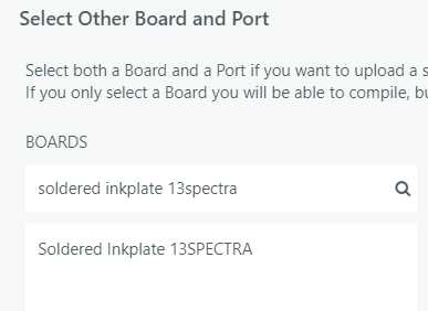

Before uploading the code, select the correct board definition. For Inkplate 13, select Soldered Inkplate 13SPECTRA.
Selected board definition for Inkplate 13SPECTRA
Select Soldered Inkplate 13SPECTRA
Click Upload in the Arduino IDE.
Arduino IDE Upload Button
Once the process completes, Inkplate will restart automatically and run the newly uploaded code. Arduino's upload log should read:
Leaving...
Hard resetting via RTS pin...
That's how you know you did everything correctly!
