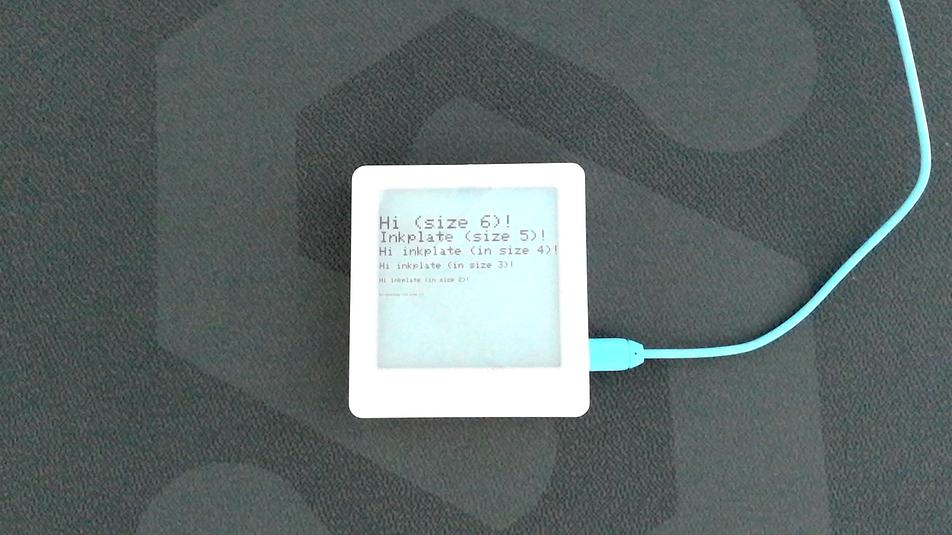

Simple text printing​
To print text, use setCursor followed by print. If you're using the default font, you may want to use setTextSize to increase the font size:
#include "Inkplate.h"
Inkplate inkplate(INKPLATE_3BIT);
void setup() {
inkplate.begin();
inkplate.clearDisplay();
inkplate.display();
inkplate.setTextColor(BLACK);
inkplate.setCursor(100,100);
inkplate.setTextSize(6);
inkplate.print("Hi (size 6)!");
inkplate.setCursor(100,150);
inkplate.setTextSize(5);
inkplate.print("Inkplate (size 5)!");
inkplate.setCursor(100,200);
inkplate.setTextSize(4);
inkplate.print("Hi inkplate (in size 4)!");
inkplate.setCursor(100,250);
inkplate.setTextSize(3);
inkplate.print("Hi inkplate (in size 3)!");
inkplate.setCursor(100,300);
inkplate.setTextSize(2);
inkplate.print("Hi inkplate (in size 2)!");
inkplate.setCursor(100,350);
inkplate.setTextSize(1);
inkplate.print("Hi inkplate (in size 1)!");
inkplate.display();

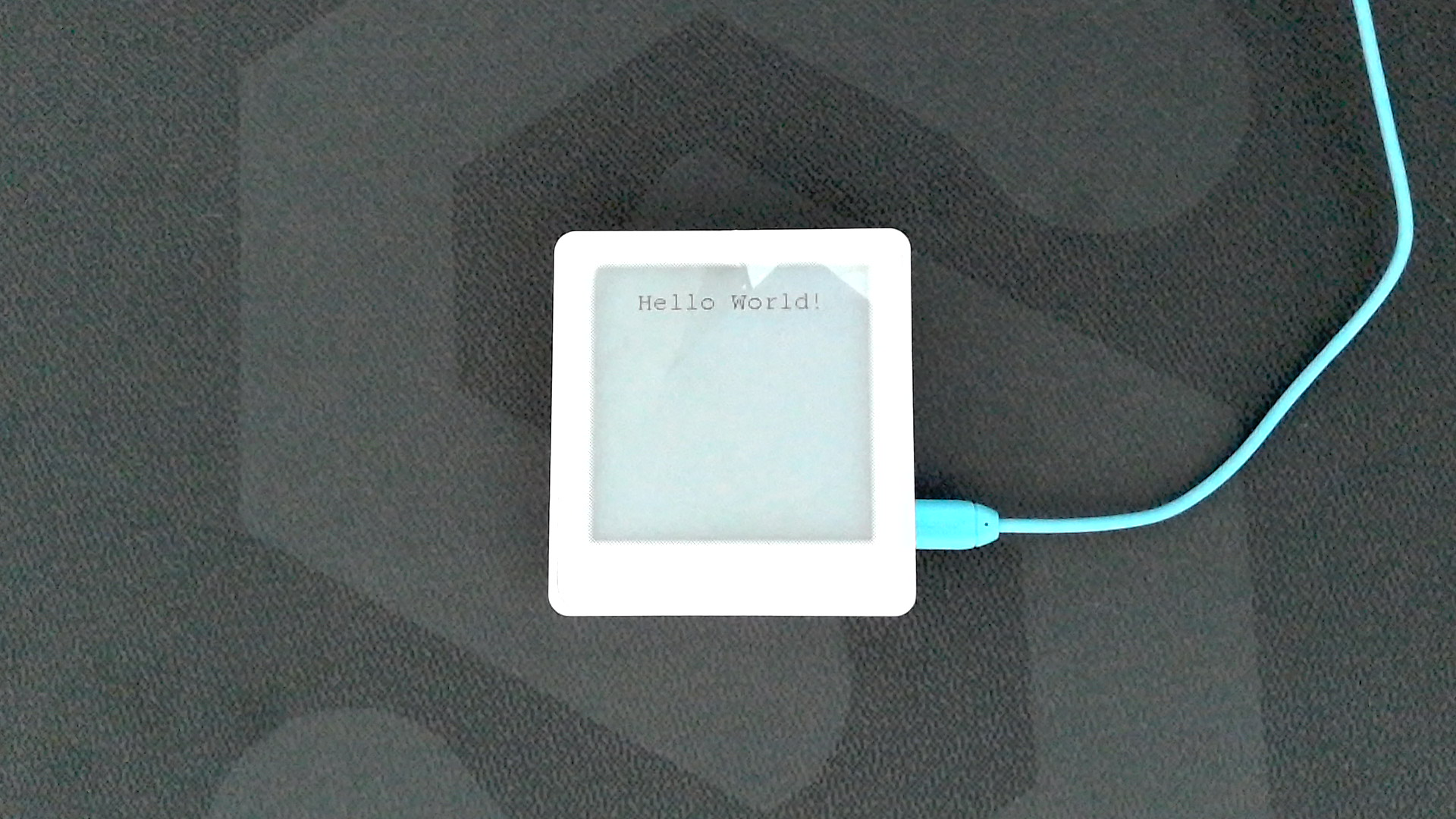

Custom fonts​
The default font appears blocky because it is optimized for minimal memory usage. You can use custom fonts by downloading them from the Adafruit GFX official repository. Adafruit provides well-documented examples of using custom fonts here.
After downloading a font, place it in your sketch folder, include it, and use setFont:
#include "FreeMono9pt7b.h"
void setup() {
inkplate.begin();
inkplate.display();
inkplate.setFont(&FreeMono9pt7b);
inkplate.print("Hello World!");
inkplate.display();
void loop() {
