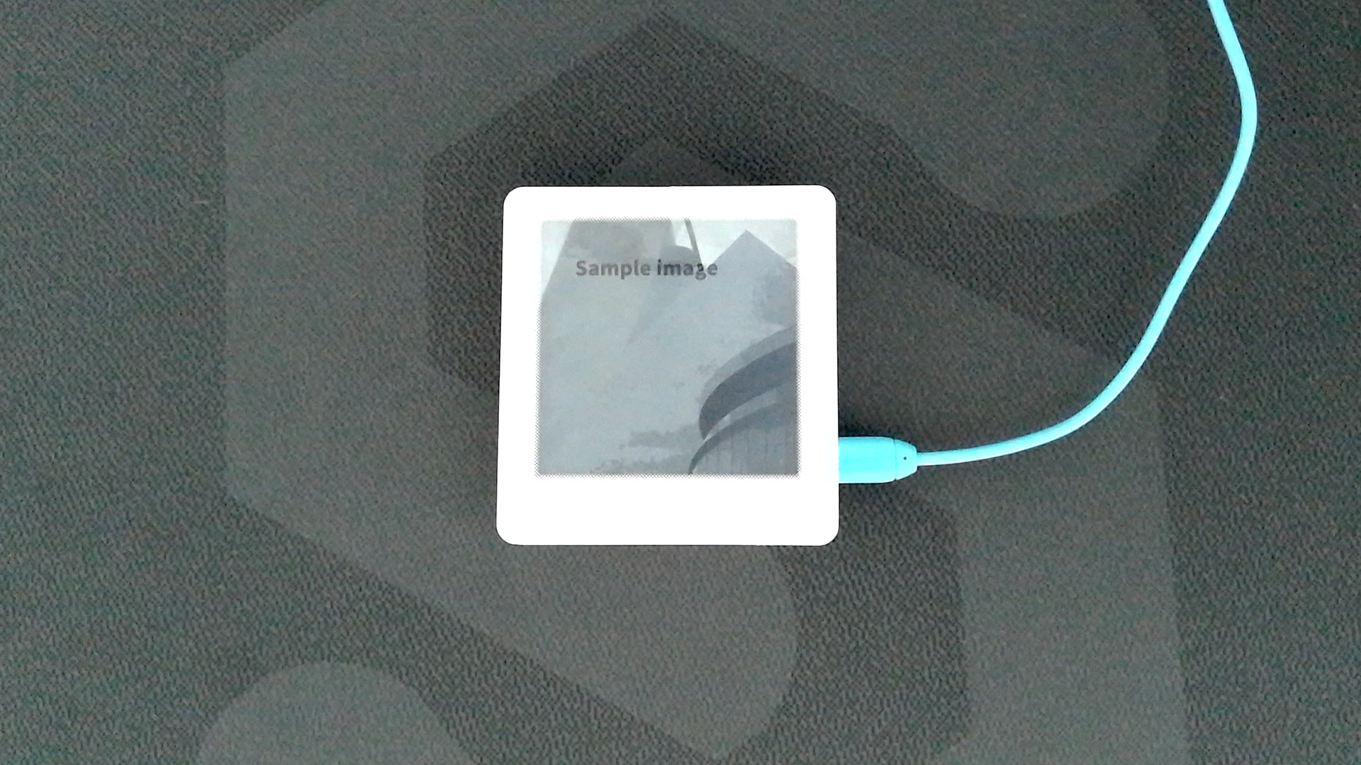

Let's draw this image of the Eurodom building in Osijek, Croatia, on Inkplate 4TEMPERA:
Example Image
Example image by @filipbaotic on Pexels

Example Image
