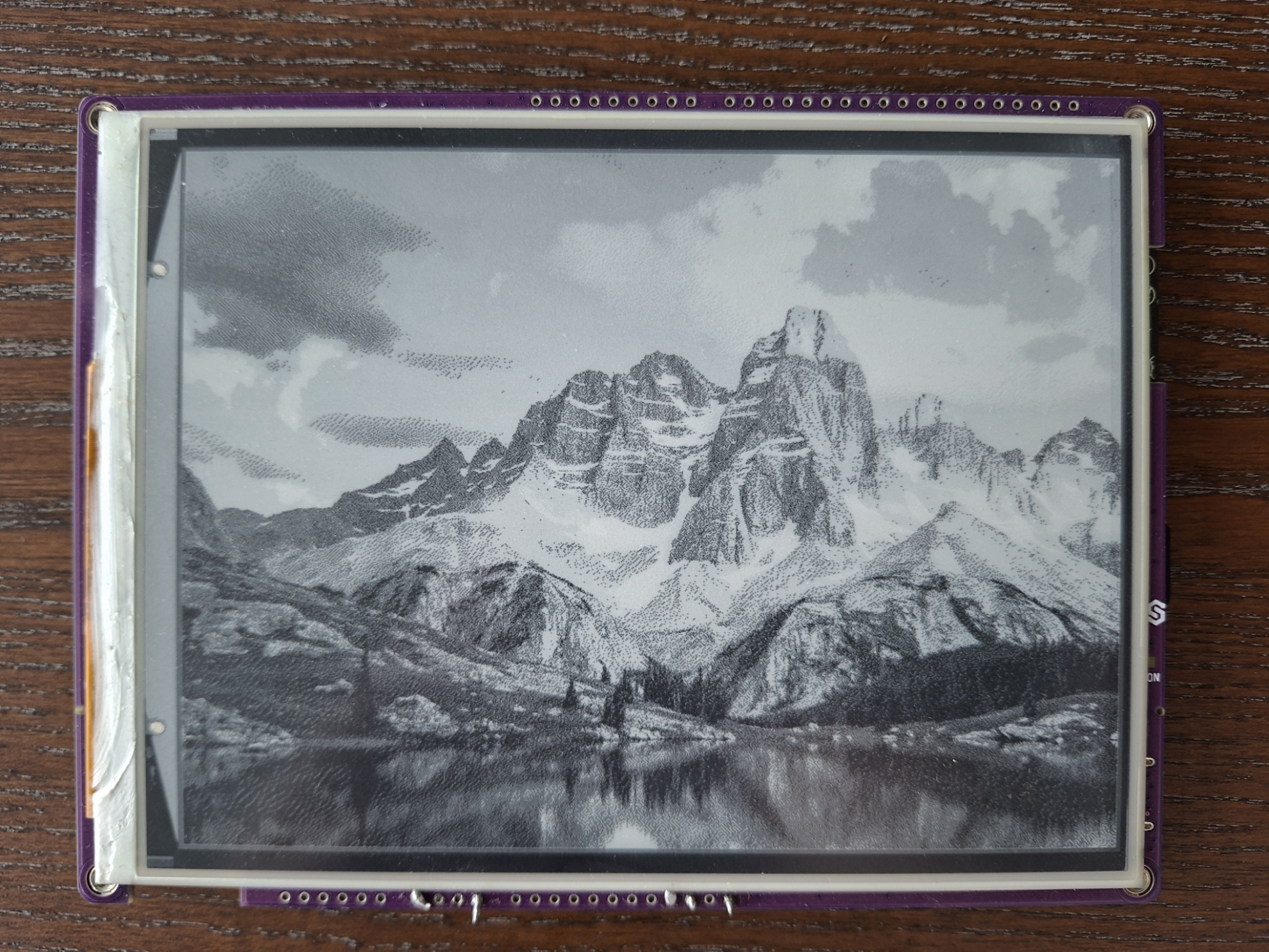

Inkplate 6 running the example code
Displaying an image from web.
