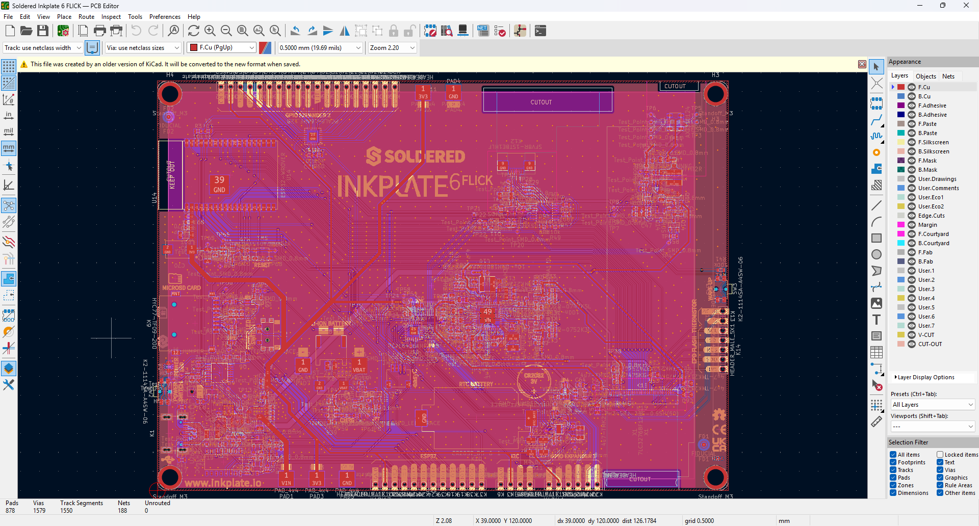

CAD files​
We use KiCad, an open-source PCB design tool. You can open and edit the .kicad_pro project file, which includes both the schematic and the PCB layout.
Inkplate 6FLICK KiCad project

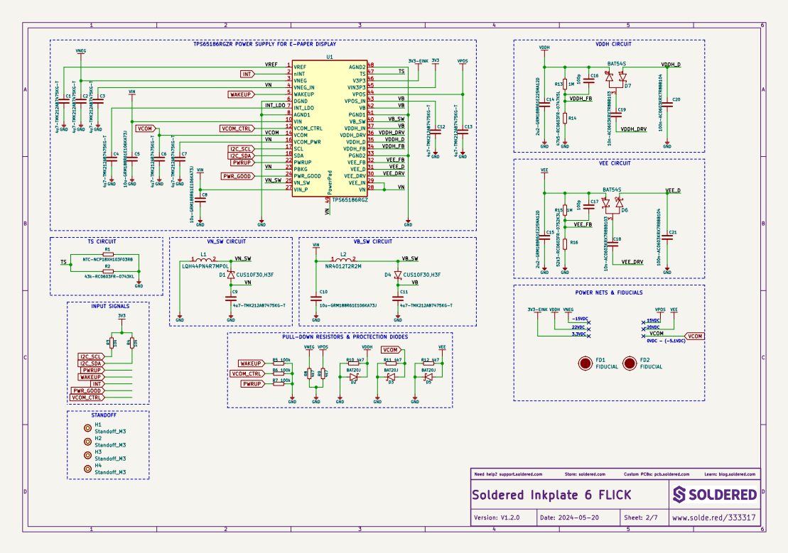

Schematic​
The OUTPUTS folder contains the schematic in .pdf format, exported from KiCad. The schematic is divided into sections based on functionality, making it easy to navigate.
Inkplate 6FLICK schematic
Inkplate 6FLICK schematic 2/7

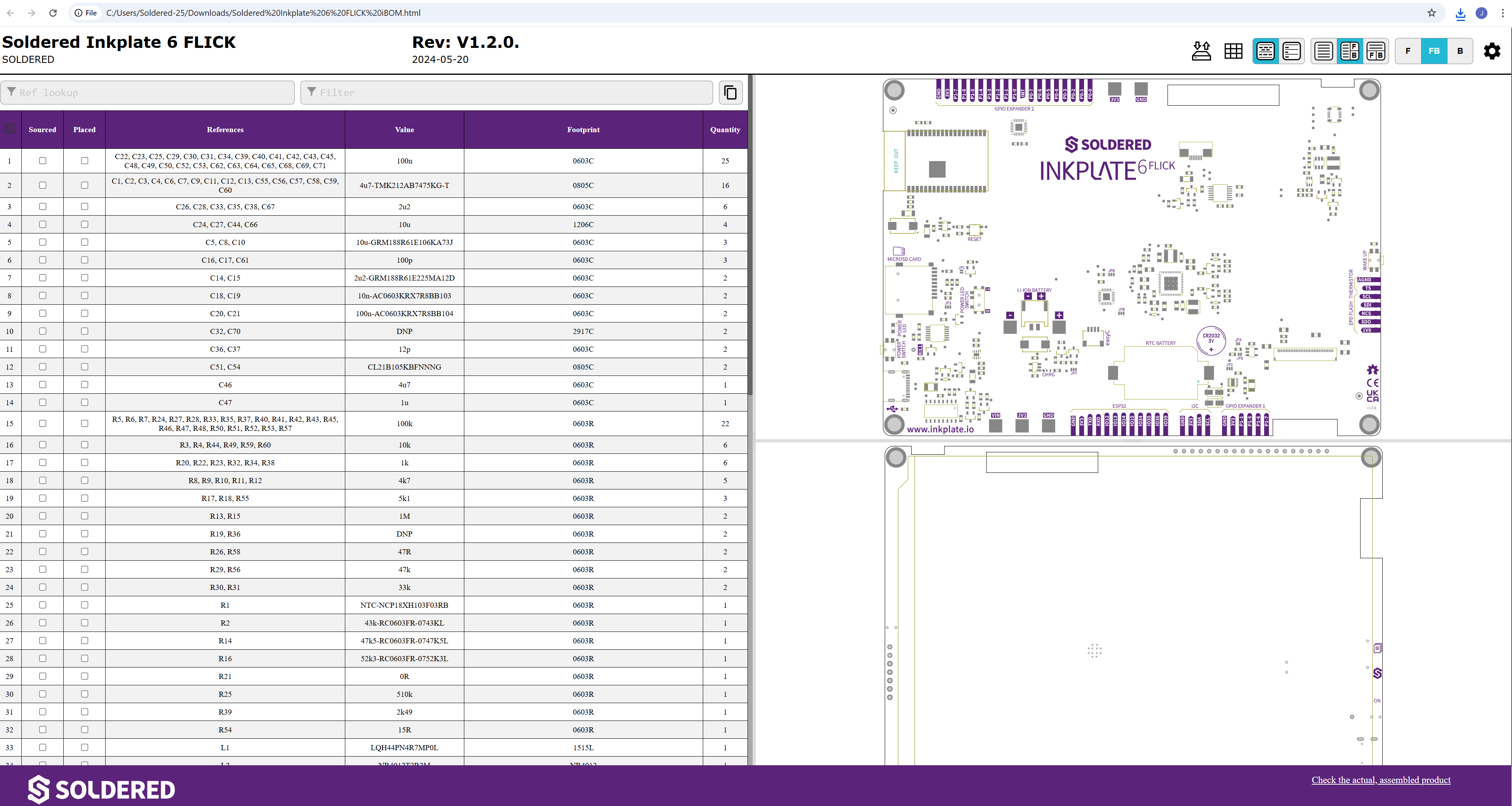

BOM (Bill of Materials)​
Inkplate 6FLICK interactive BOM
IBOM for 6FLICK
