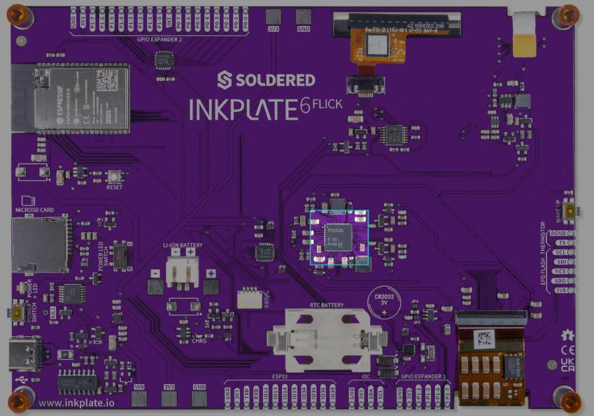

Inkplate 6FLICK integrates TPS65186 power supply chip for e-paper display. The chip supports measurement of an external NTC (Negative Temperature Coefficient) thermistor allowing monitoring of display panel temperature in range from -10°C to 85°C. This in turn can be used to give an approximate room temperature measurements.
Note that the readings are intended for onboard temperature monitoring and are only an approximation of room temperature!
TPS highlight image
Onboard TPS chip
