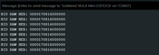

auto events = parser.pollEvents();
if (events.hidRaw.valid)
Serial.print("HID RAW HEX: ");
Serial.println(events.hidRaw.hex);

Raw HID example output from Serial Monitor
