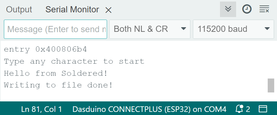

If everything works as it should, you should get an output like this:
Successful file read
