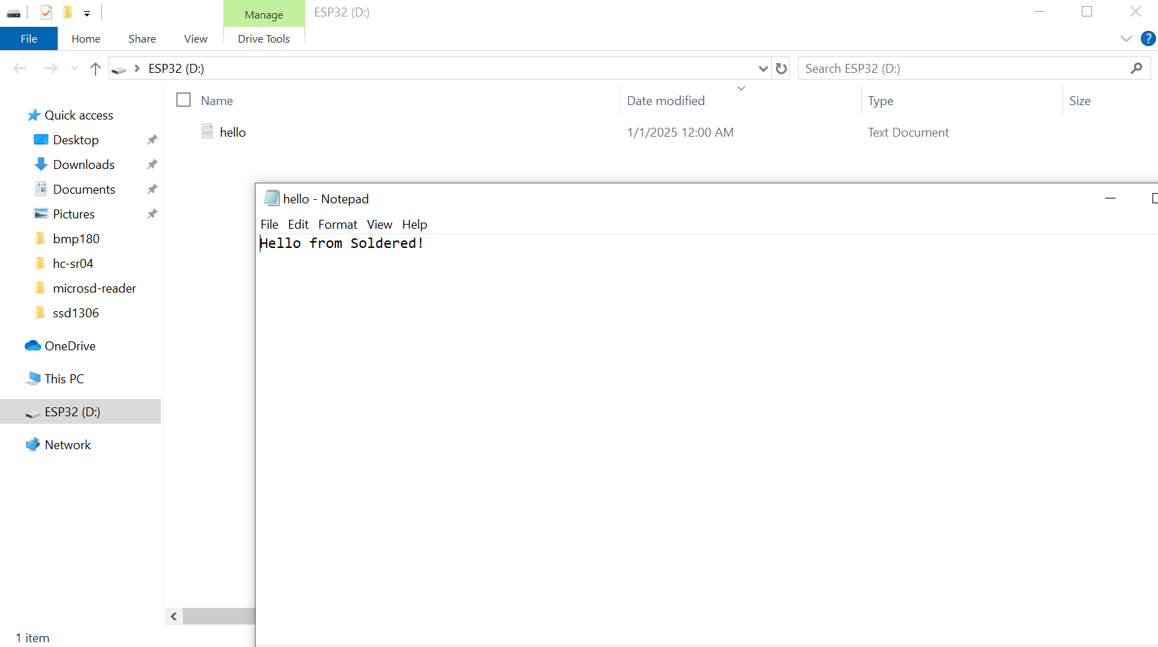

If the file creation and writing are successful, when connected to a computer, we can see and open the created file:
Successful file writing
