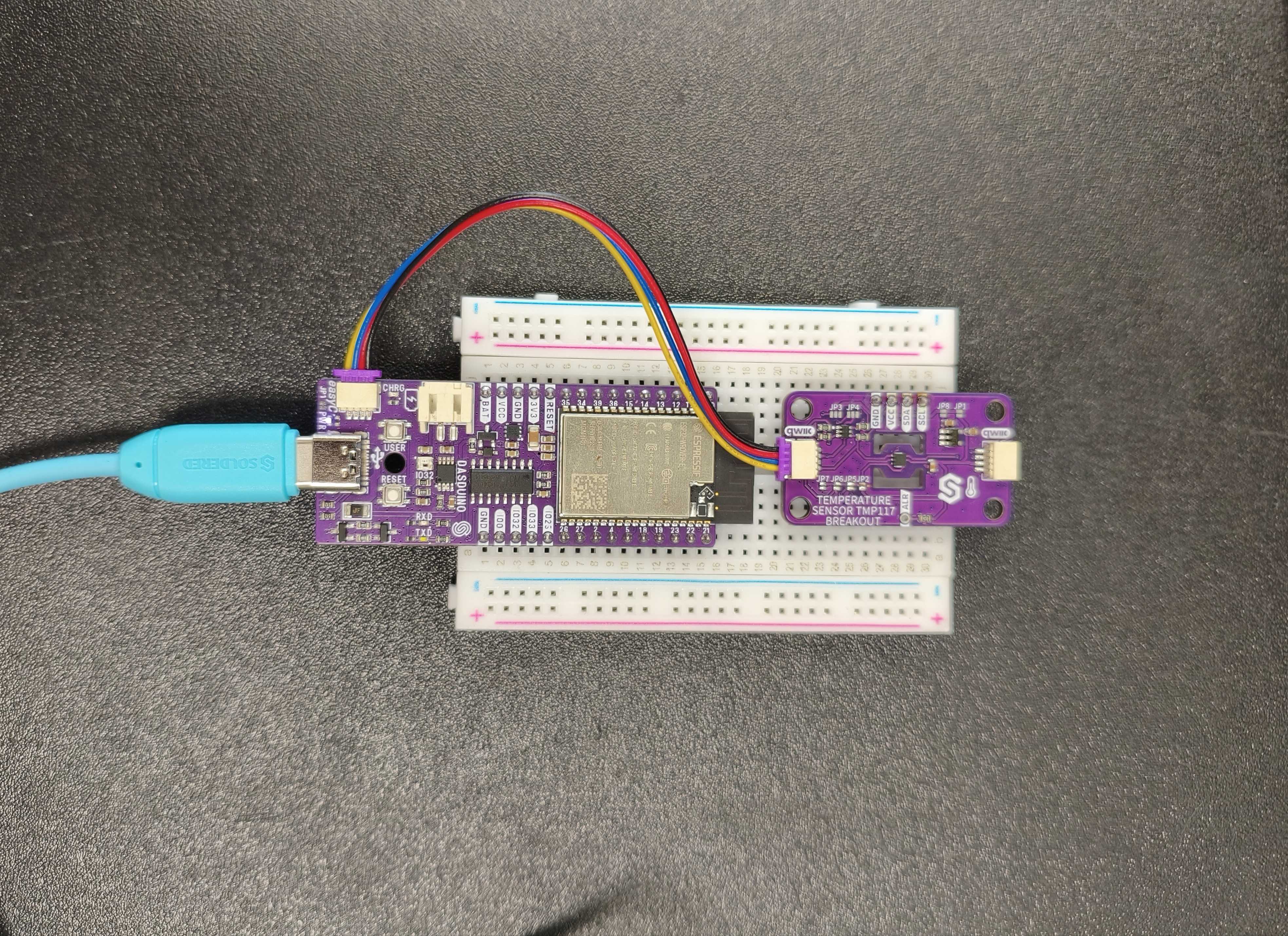

Dasduino CONNECTPLUS connected to TMP117 temperature sensor via Qwiic connector.

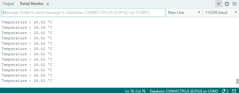

Serial Monitor output
Simple periodic temperature readout.
