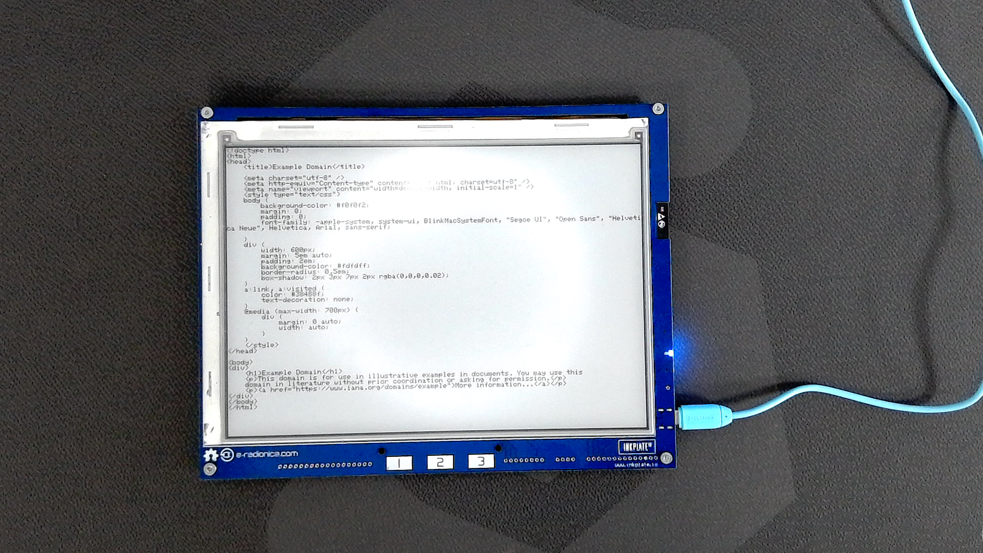

GET request​
Using client.GET() will enable you to easily download and handle data on Inkplate however you want. Here is an example on how to GET a .html file and print it on Inkplate:
#include <HTTPClient.h> //Include HTTP library to this sketch
#include <WiFi.h> //Include ESP32 WiFi library to our sketch
#define ssid "yourssid" // Name of the WiFi network (SSID) that you want to connect Inkplate to
#define pass "yourpassword" // Password of that WiFi network
void setup()
display.setTextSize(2); // Set text scaling to two (text will be two times bigger)
display.setCursor(0, 0); // Set print position
display.setTextColor(BLACK, WHITE); // Set text color to black and background color to white
display.println("Scanning for WiFi networks..."); // Write text
display.display(); // Send everything to display (refresh display)
int n = WiFi.scanNetworks(); // Start searching WiFi networks and put the number of found WiFi networks in variable
// n
if (n == 0)
{ // If you did not find any network, show the message and stop the program.
display.print("No WiFi networks found!");
display.partialUpdate();
while (true)
else
if (n > 10)
n = 10; // If you did find, print name (SSID), encryption and signal strength of first 10 networks
for (int i = 0; i < n; i++)
display.print(WiFi.SSID(i));
display.print((WiFi.encryptionType(i) == WIFI_AUTH_OPEN) ? 'O' : '*');
display.print('\n');
display.print(WiFi.RSSI(i), DEC);
display.partialUpdate(); //(Partial) refresh the screen
display.clearDisplay(); // Clear everything in frame buffer
display.setCursor(0, 0); // Set print cursor to new position
display.print("Connecting to "); // Print the name of WiFi network
display.print(ssid);
WiFi.begin(ssid, pass); // Try to connect to WiFi network
while (WiFi.status() != WL_CONNECTED)
delay(1000); // While it is connecting to network, display dot every second, just to know that Inkplate is
// alive.
display.print('.');
display.print("connected"); // If it's connected, notify user
HTTPClient http;
if (http.begin("http://example.com/index.html"))
{ // Now try to connect to some web page (in this example www.example.com. And yes, this is a valid Web page :))
if (http.GET() > 0)
{ // If connection was successful, try to read content of the Web page and display it on screen
String htmlText;
htmlText = http.getString();
display.setTextSize(1); // Set smaller text size, so everything can fit on screen
display.print(htmlText);
display.display();
