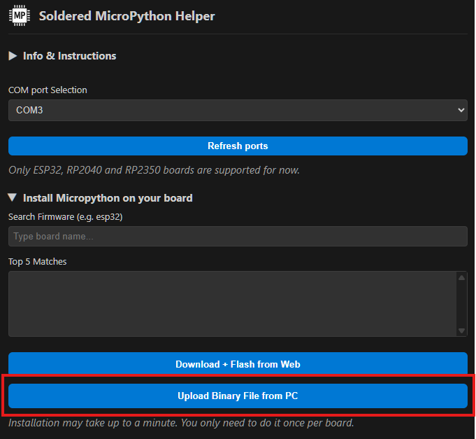

After setting up the MicroPython Helper extension, go to Install Micropython on your board and pick Upload Binary file from PC, choose the Inkplate-firmware.bin file and wait for it to flash on the device.
Uploading the firmware binary from VS Code
Upload .bin file to device

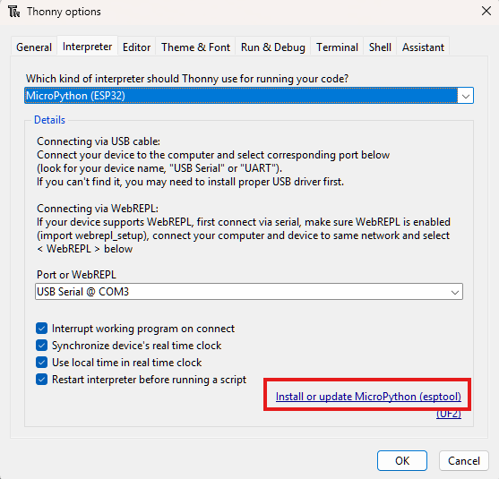

In the Thonny IDE, go to Run -> Configure interpreter and on the bottom of the window go to Install or update Micropython.
Thonny interpreter configuration

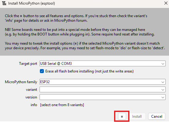

On the bottom of that window click on the ≡ button and pick Select local MicroPython image, choose the Inkplate-firmware.bin file on your computer and press Install.
Selecting a local MicroPython image in Thonny
Select Micropython image
