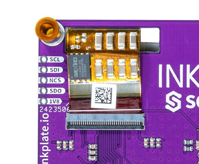

4. Inspect the e-paper flat cable and panel​
  • Examine the flat-flex cable connector to ensure it's properly seated.
  • Check the edges of the e-paper panel for any visible damage or cracks.

2. Check the e-paper flat cable connector​
If artifacts persist after cleaning or appear as long vertical lines or streaks, it may indicate a loose, improperly connected, or possibly damaged flat cable.
Try re-seating the e-paper flat cable by carefully disconnecting and reconnecting it.
