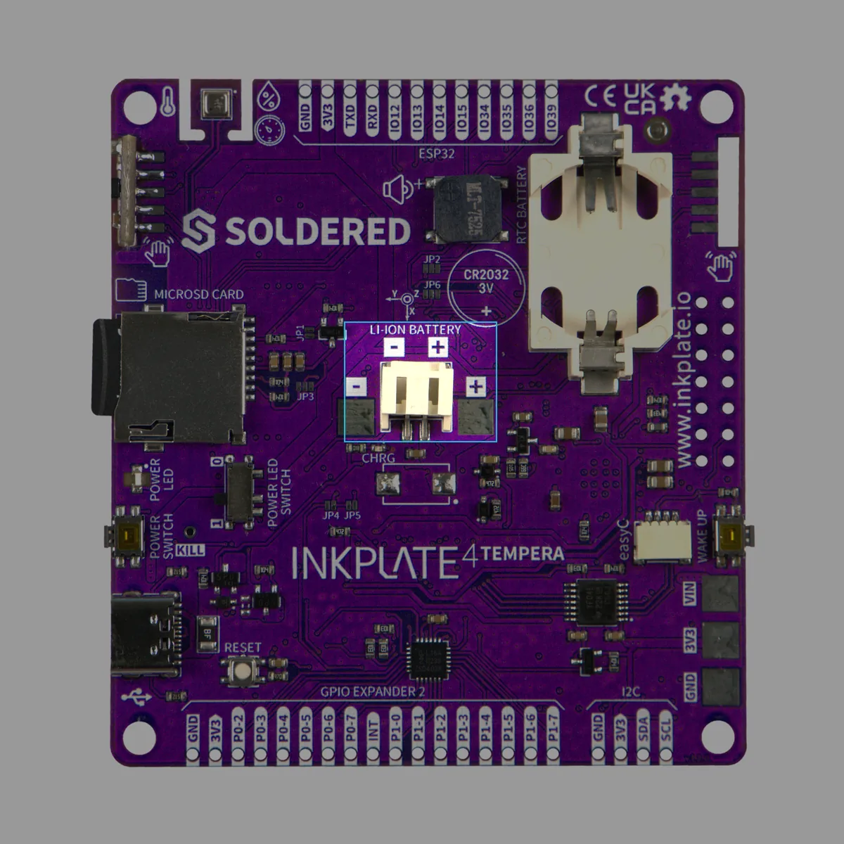

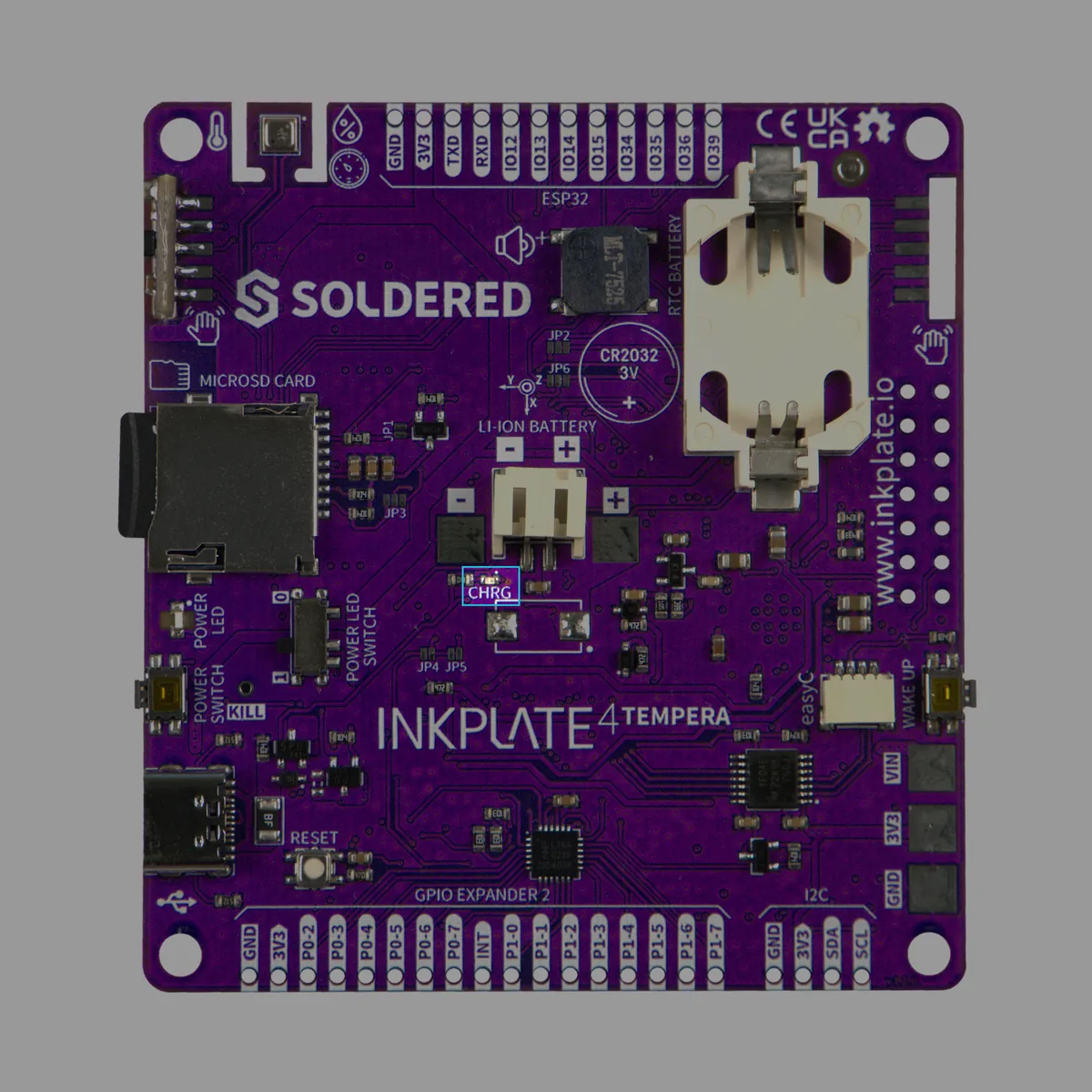

Inkplate 4TEMPERA includes a 2-pin 2mm JST connector, allowing you to connect a 3.7V Li-ion battery. The onboard charging IC, MCP73831, automatically charges the battery when the Inkplate is plugged into USB-C and switches to battery power when unplugged. A charging indicator LED provides real-time charging status.
Inkplate 4TEMPERA battery JST connector
JST battery connector
Inkplate 4TEMPERA Onboard charging indicator LED
The correct battery polarity is essential! Check the markings on the PCB before connecting a battery. When orienting the JST connector with the notch at the top, the positive (+) terminal is on the left, and the negative (-) terminal is on the right.
Battery polarity on Inkplate 4TEMPERA
Battery polarity can vary! Some Li-ion batteries have reversed polarity. Connecting a battery with the wrong polarity may permanently damage your Inkplate! Double-check before plugging it in.
