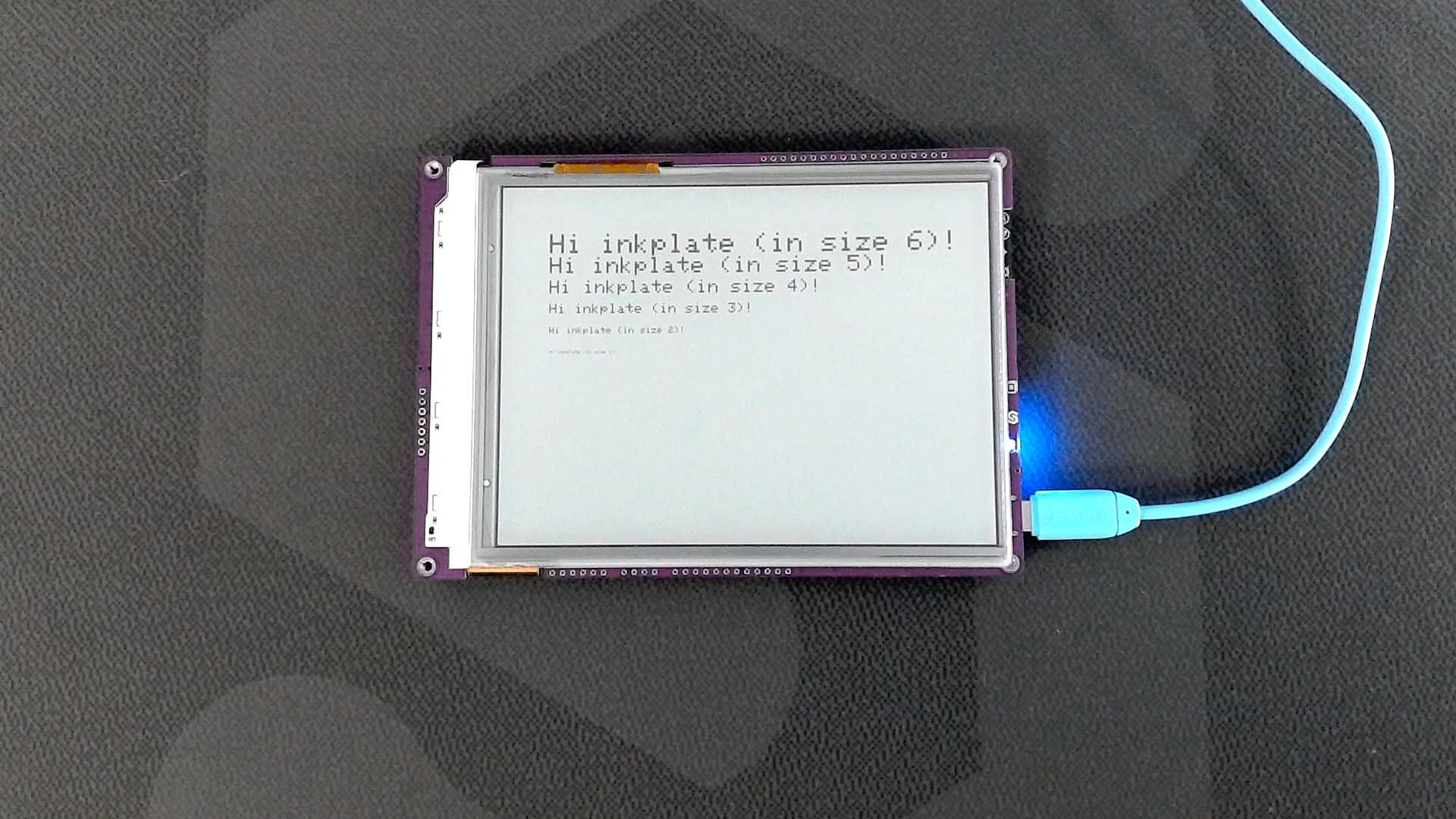

Simple text printing​
To print text, use setCursor followed by print. If you're using the default font, you may want to use setTextSize to increase the font size:
#include "Inkplate.h"
Inkplate display(INKPLATE_3BIT);
void setup() {
display.begin();
display.clearDisplay();
display.display();
display.setTextColor(BLACK);
display.setCursor(100,100);
display.setTextSize(6);
display.print("Hi inkplate (in size 6)!");
display.setCursor(100,150);
display.setTextSize(5);
display.print("Hi inkplate (in size 5)!");
display.setCursor(100,200);
display.setTextSize(4);
display.print("Hi inkplate (in size 4)!");
display.setCursor(100,250);
display.setTextSize(3);
display.print("Hi inkplate (in size 3)!");
display.setCursor(100,300);
display.setTextSize(2);
display.print("Hi inkplate (in size 2)!");
display.setCursor(100,350);
display.setTextSize(1);
display.print("Hi inkplate (in size 1)!");
display.display();
void loop() {
display.setTextSize()
Increases the text size by a given factor.
Returns value: None
Function parameters:
TypeNameDescription
uint8_tsSize factor. 1 is default size, 2 is twice as large, 3 is three times larger, etc.

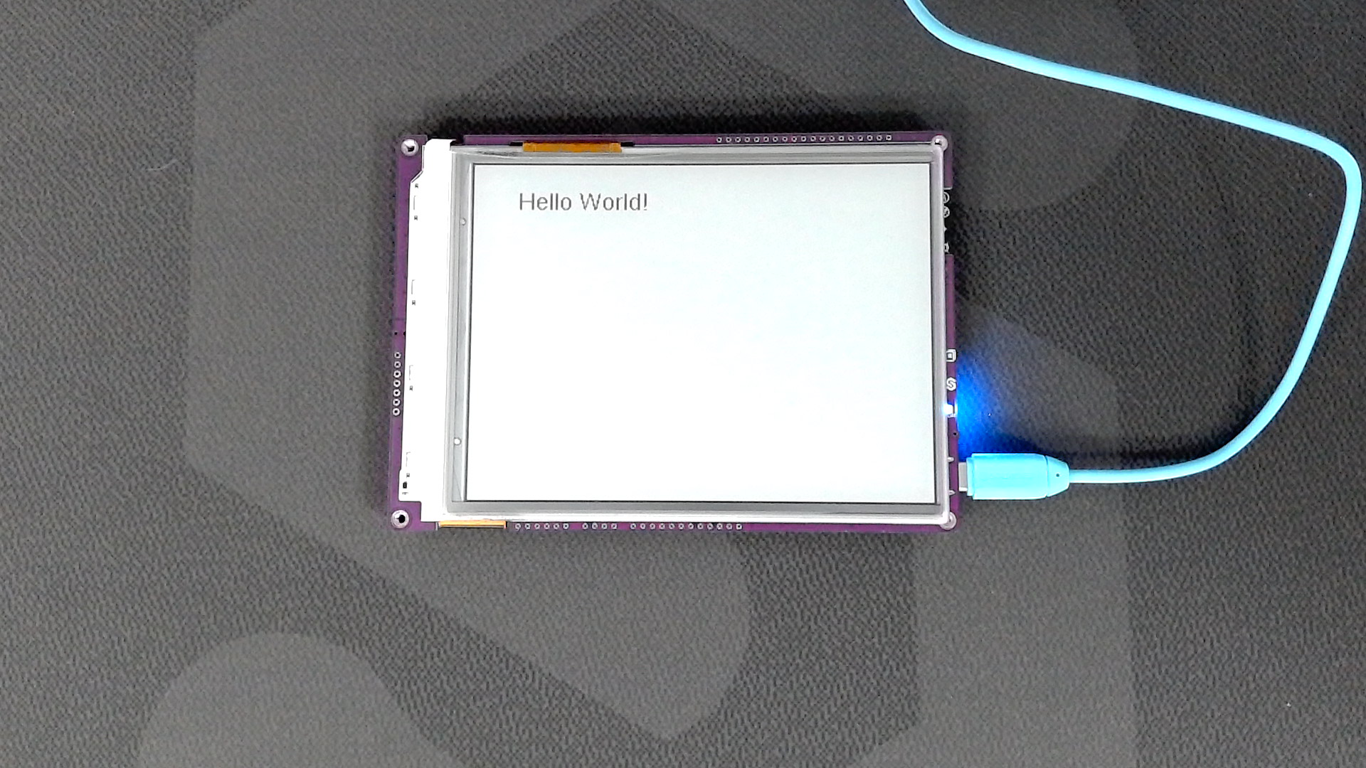

Custom fonts​
The default font appears blocky as it is optimized for minimal memory usage. You can use custom fonts by downloading them from the Adafruit GFX official repository. Adafruit provides well-documented examples on using custom fonts here.
After downloading a font, place it in your sketch folder, include it, and use setFont:
#include "FreeMono9pt7b.h"
void setup() {
display.begin();
display.display();
display.setFont(&FreeMono9pt7b);
display.print("Hello World!");
display.display();
void loop() {
display.setFont()
Sets a custom font for text printing. Must be called before printing.
Returns type: None
TypeNameDescription
const GFXfont *fpointer to the GFXfont structure of the font to be set.
