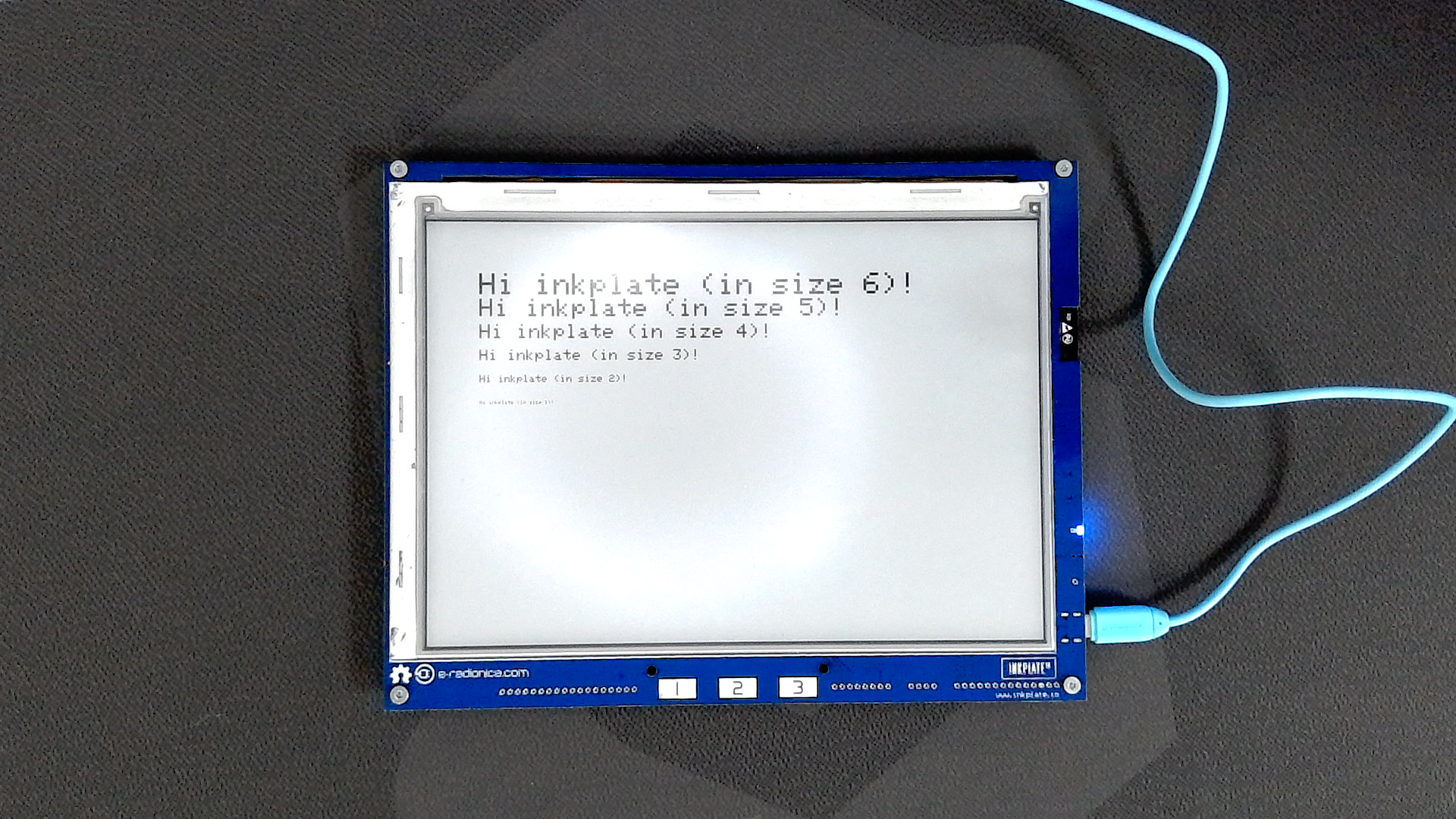

Simple text printing​
To print text, use setCursor followed by print. If you're using the default font, you may want to use setTextSize to increase the font size:
#include "Inkplate.h"
Inkplate display(INKPLATE_3BIT);
void setup() {
display.begin();
display.clearDisplay();
display.display();
display.setTextColor(BLACK);
display.setCursor(100,100);
display.setTextSize(6);
display.print("Hi inkplate (in size 6)!");
display.setCursor(100,150);
display.setTextSize(5);
display.print("Hi inkplate (in size 5)!");
display.setCursor(100,200);
display.setTextSize(4);
display.print("Hi inkplate (in size 4)!");
display.setCursor(100,250);
display.setTextSize(3);
display.print("Hi inkplate (in size 3)!");
display.setCursor(100,300);
display.setTextSize(2);
display.print("Hi inkplate (in size 2)!");
display.setCursor(100,350);
display.setTextSize(1);
display.print("Hi inkplate (in size 1)!");
display.display();

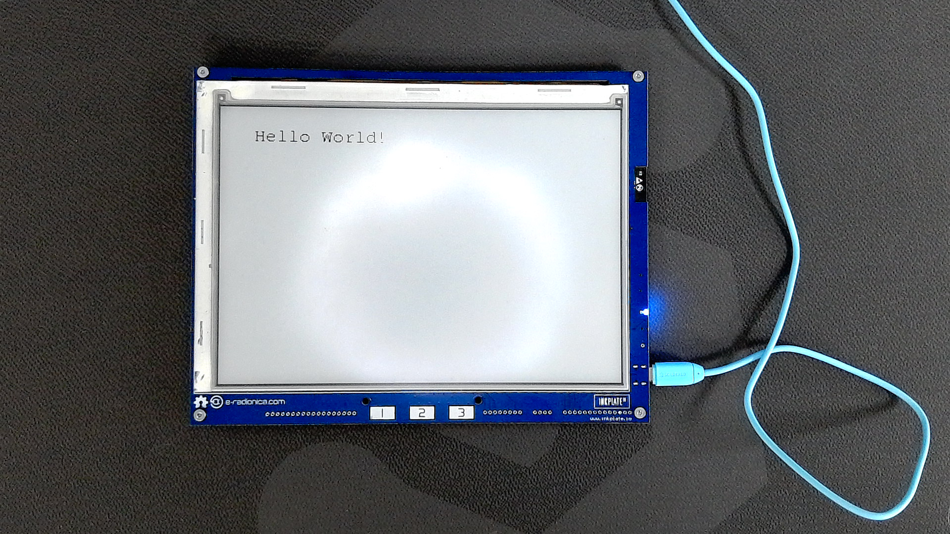

Custom fonts​
The default font appears blocky as it is optimized for minimal memory usage. You can use custom fonts by downloading them from the Adafruit GFX official repository. Adafruit provides well-documented examples on using custom fonts here.
After downloading a font, place it in your sketch folder, include it, and use setFont:
#include "FreeMono9pt7b.h"
void setup() {
display.begin();
display.display();
display.setFont(&FreeMono9pt7b);
display.print("Hello World!");
display.display();

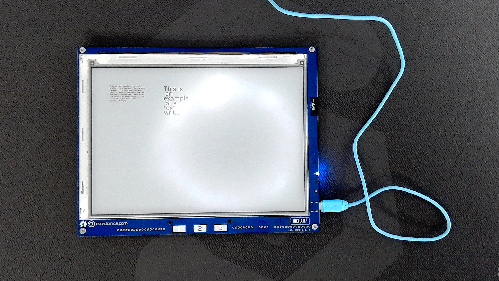

TextBox​
You can manually define the area in which text will appear by using the drawTextBox() function.
#include "Roboto_Light_36.h"
// Define the text you will show in the text box
const char* text="This is an example of a text written in a textbox. When a word doesn't fit into the current row, it goes to the next one."\
" If the text reaches the lower bound, it ends with three dots (...) to mark that the text isnt displayed fully";
void setup()
// Create a text box without any optional parameters
// x0- x coordinate of upper left corner
// y0- y coordinate of upper left corner
// x1- x coordinate of bottom right corner
// y1- y coordinate of bottom right corner
// text - text we want to display
display.drawTextBox(100,100,300,300,text);
// Create a text box with all parameters
// textSizeMultiplier - by what factor we want to enlarge the size of a font
// font - address of selected custom font
// verticalSpacing - how many pixels between each row of text
// showBorder - Create a visible rectangle around the box
// fontSize - size of the used font in pt
int offset=32; // Note - some custom fonts are drawn from bottom-to-top which requires an offset, use an offset that best suits the font you use
display.drawTextBox(400,100+offset,600,300,text,1,&Roboto_Light_36,27,false,36);
// Display both text boxes
display.display();
void loop()
// Nothing...
This example uses a custom font (Roboto_Light_36.h) alongside the main .ino file. Get both files from the example folder on GitHub and keep them in the same sketch folder.
