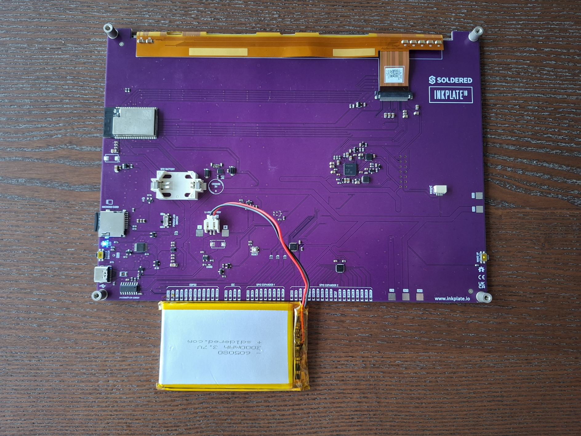

You need a Li-ion battery for this example to work, to learn more, check out battery docs page.
Battery should be connected like this:
Inkplate 10 running the example code
Battery connected to Inkplate 10.

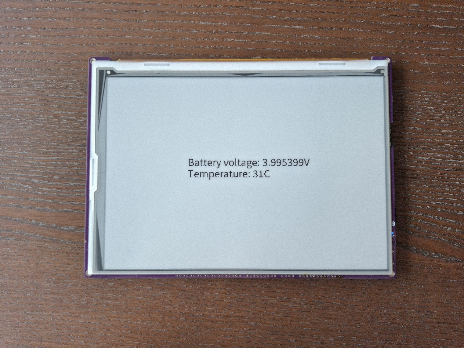

Displaying battery and temperature data on Inkplate display.
