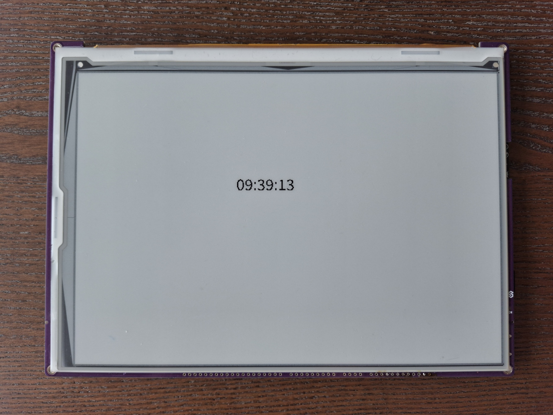

This example shows how to set the RTC time and date, and then continuously display the current time on the screen.

Inkplate 10 running the example code
