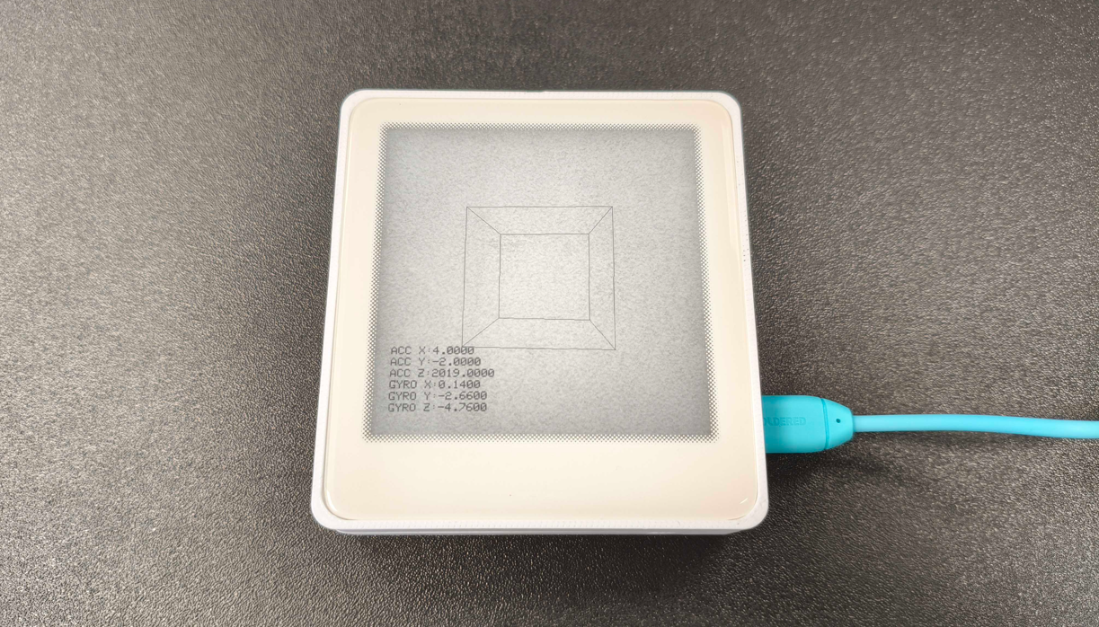

3D projection demo​
In the official example, the LSM6DS3's accelerometer values are used to control the tilt of a 3D wireframe cube, illustrating how orientation data can be used for interactive graphics:
  • 3D cube rendered using trigonometry and vector rotation
  • Accelerometer values used to rotate the cube in real time
  • Gyroscope and acceleration values printed on screen
  • Optimized display refresh using partialUpdate() and periodic full display() calls
The 3D projection is a visualization technique that smooths motion by using the previous accelerometer value to reduce jitter and increase realism.
Full example display
This sketch uses real-time accelerometer data to rotate a projected cube on the e-paper display. Each corner of the cube is rotated in 3D space and then projected onto the 2D screen. To avoid flickering, the cube is updated using partialUpdate() until 35 frames have passed, at which point a full display() refresh is performed.
