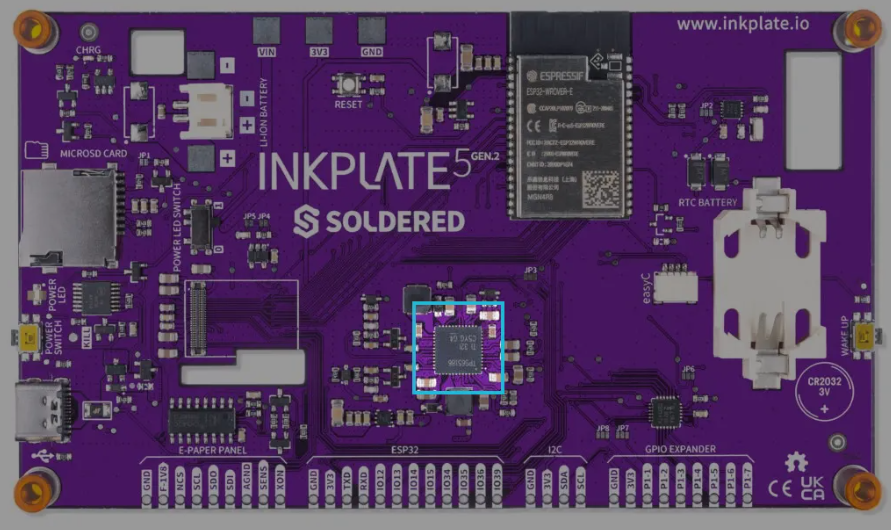

Inkplate 5V2 uses the TPS65186 power supply chip to drive the e-paper display. The chip can measure an external NTC (Negative Temperature Coefficient) thermistor, so you can monitor the display panel temperature in the range from -10°C to 85°C. That also gives you an approximate room temperature reading.
The readings are meant for onboard temperature monitoring, so treat them as an approximation of room temperature.
Onboard TPS chip
