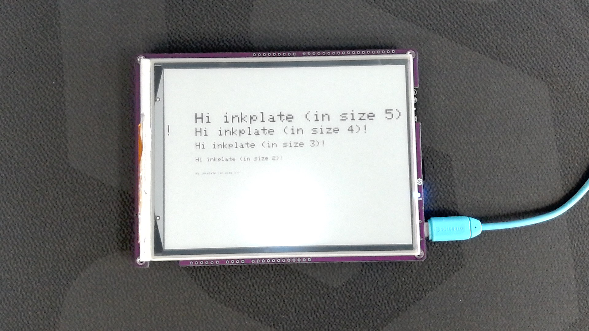

To print text, use setCursor followed by print. If you're using the default font, you may want to use setTextSize to increase the font size:
#include "Inkplate.h"
Inkplate display(INKPLATE_3BIT);
void setup() {
display.begin();
display.clearDisplay();
display.display();
display.setTextColor(BLACK);
display.setCursor(100,150);
display.setTextSize(5);
display.print("Hi inkplate (in size 5)!");
display.setCursor(100,200);
display.setTextSize(4);
display.print("Hi inkplate (in size 4)!");
display.setCursor(100,250);
display.setTextSize(3);
display.print("Hi inkplate (in size 3)!");
display.setCursor(100,300);
display.setTextSize(2);
display.print("Hi inkplate (in size 2)!");
display.setCursor(100,350);
display.setTextSize(1);
display.print("Hi inkplate (in size 1)!");
display.display();

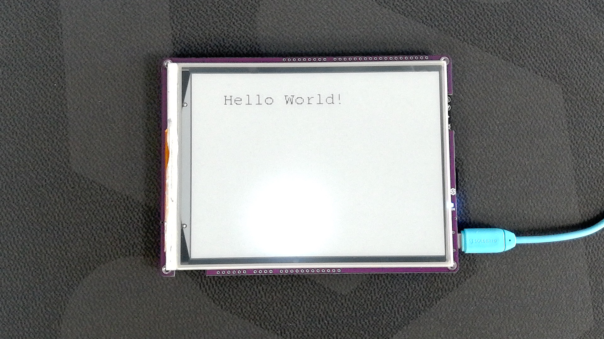

The default font appears blocky because it is optimized for minimal memory usage. You can use custom fonts by downloading them from the Adafruit GFX official repository. Adafruit also provides well-documented examples on using custom fonts here.
After downloading a font, place it in your sketch folder, include it, and use setFont:
#include "FreeMono9pt7b.h"
void setup() {
display.begin();
display.display();
display.setFont(&FreeMono9pt7b);
display.setCursor(100,100);
display.print("Hello World!");
display.display();

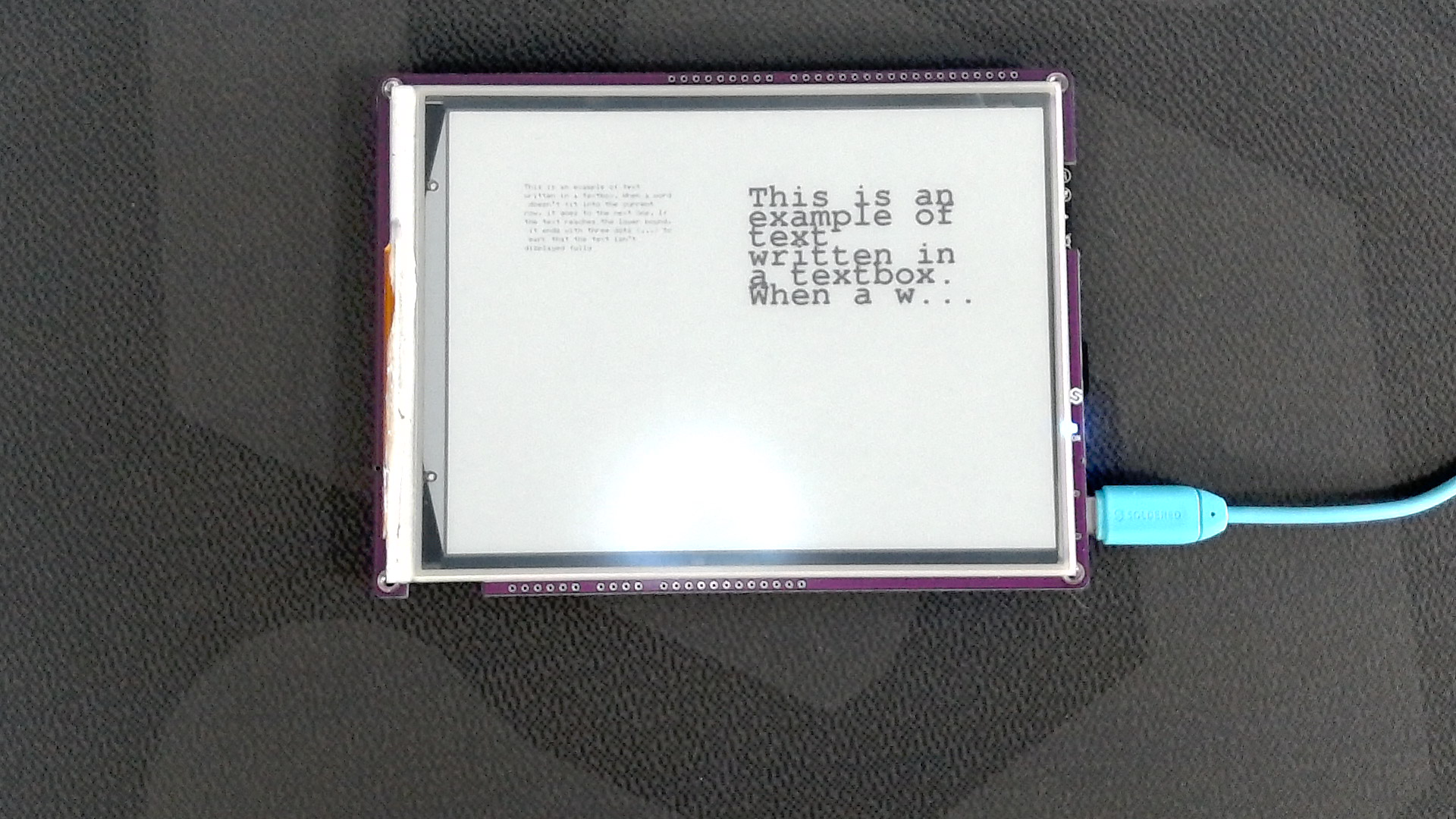

You can manually define the area in which text will appear by using the drawTextBox() function.
#include "Roboto_Light_36.h"
// Define the text you will show in the text box
const char* text="This is an example of a text written in a textbox. When a word doesn't fit into the current row, it goes to the next one."\
" If the text reaches the lower bound, it ends with three dots (...) to mark that the text isnt displayed fully";
void setup()
// Create a text box without any optional parameters
// x0- x coordinate of upper left corner
// y0- y coordinate of upper left corner
// x1- x coordinate of bottom right corner
// y1- y coordinate of bottom right corner
// text - text we want to display
display.drawTextBox(100,100,300,300,text);
// Create a text box with all parameters
// textSizeMultiplier - by what factor we want to enlarge the size of a font
// font - address of selected custom font
// verticalSpacing - how many pixels between each row of text
// showBorder - Create a visible rectangle around the box
// fontSize - size of the used font in pt
int offset=32; // Note - some custom fonts are drawn from bottom-to-top which requires an offset, use an offset that best suits the font you use
display.drawTextBox(400,100+offset,600,300,text,1,&Roboto_Light_36,27,false,36);
// Display both text boxes
display.display();
void loop()
// Nothing...
This example uses a custom font (Roboto_Light_36.h) alongside the main .ino file. Get both files from the example folder on GitHub and keep them in the same sketch folder.
