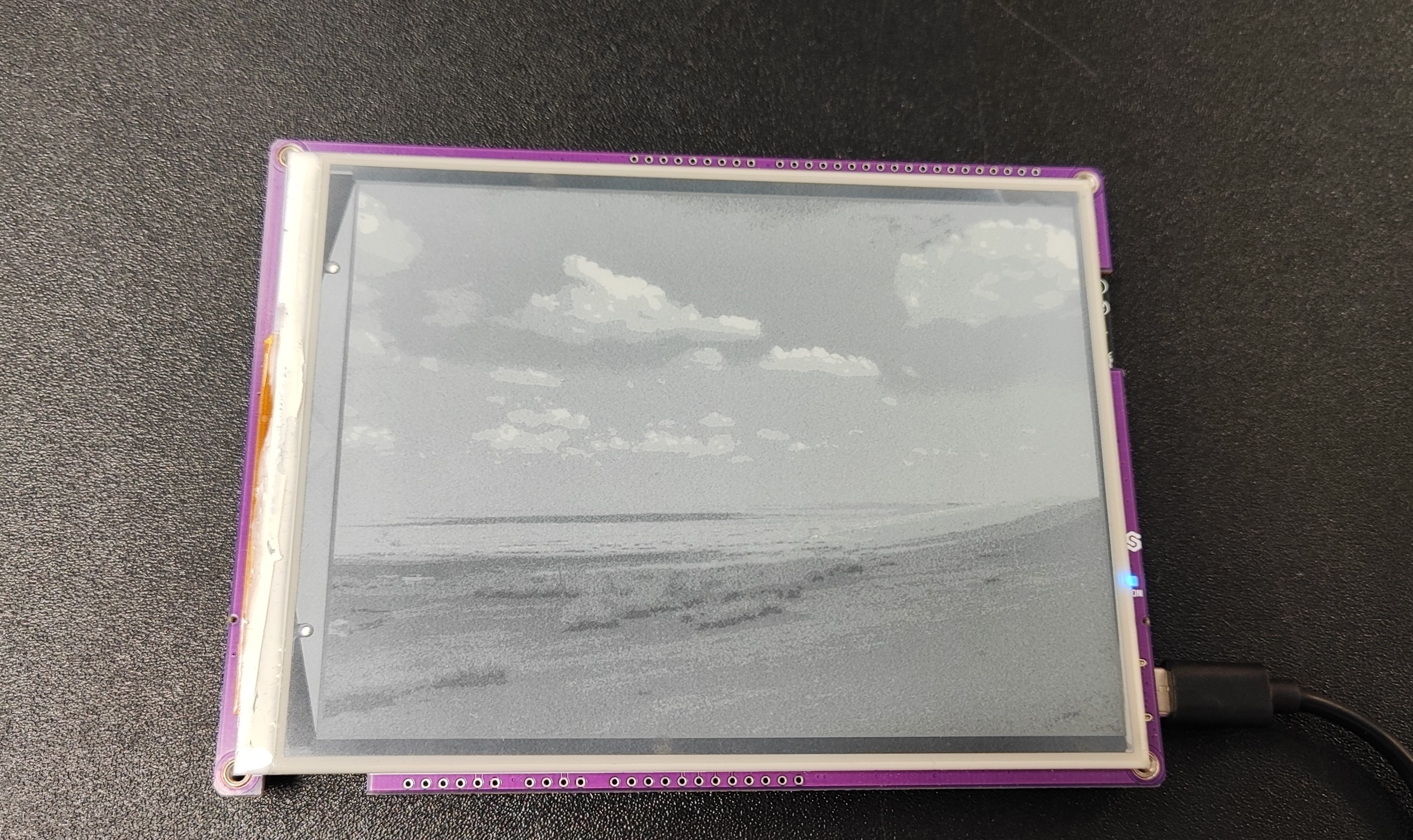

Let's draw this 800x600 landscape wallpaper from Wikimedia Commons on Inkplate 6:
Example Image
The example image, hosted on Wikimedia Commons

Example Image
Example image
