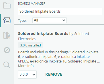

Now you can open the Boards Manager, search for Inkplate Boards, and install the Inkplate Boards board definitions.
Click Install here:
Install Inkplate boards
Adding Inkplate boards to Arduino IDE

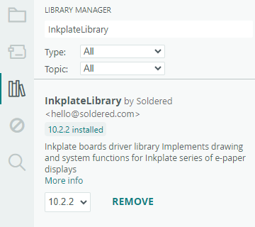

3. Install Inkplate library​
In the Arduino Library Manager, search for the Inkplate library and click Install:
Installing Inkplate library

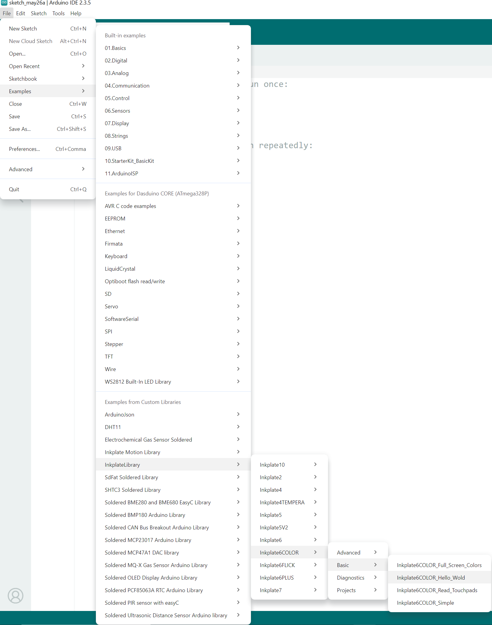

2. Create a sketch​
For this documentation, we will use a pre-made example. Go to File->Examples->InkplateLibrary->Inkplate6COLOR->Basic->Inkplate6COLOR_Hello_Wold.
Selecting a basic example for Inkplate 6COLOR
