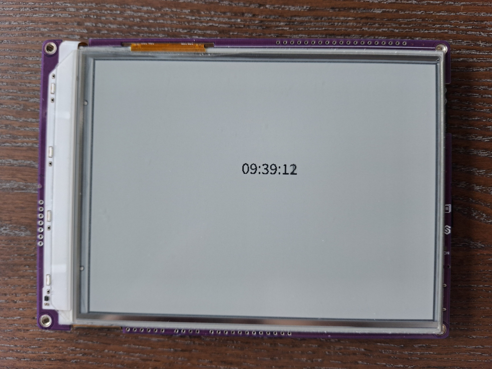

Inkplate 6FLICK running the example code
