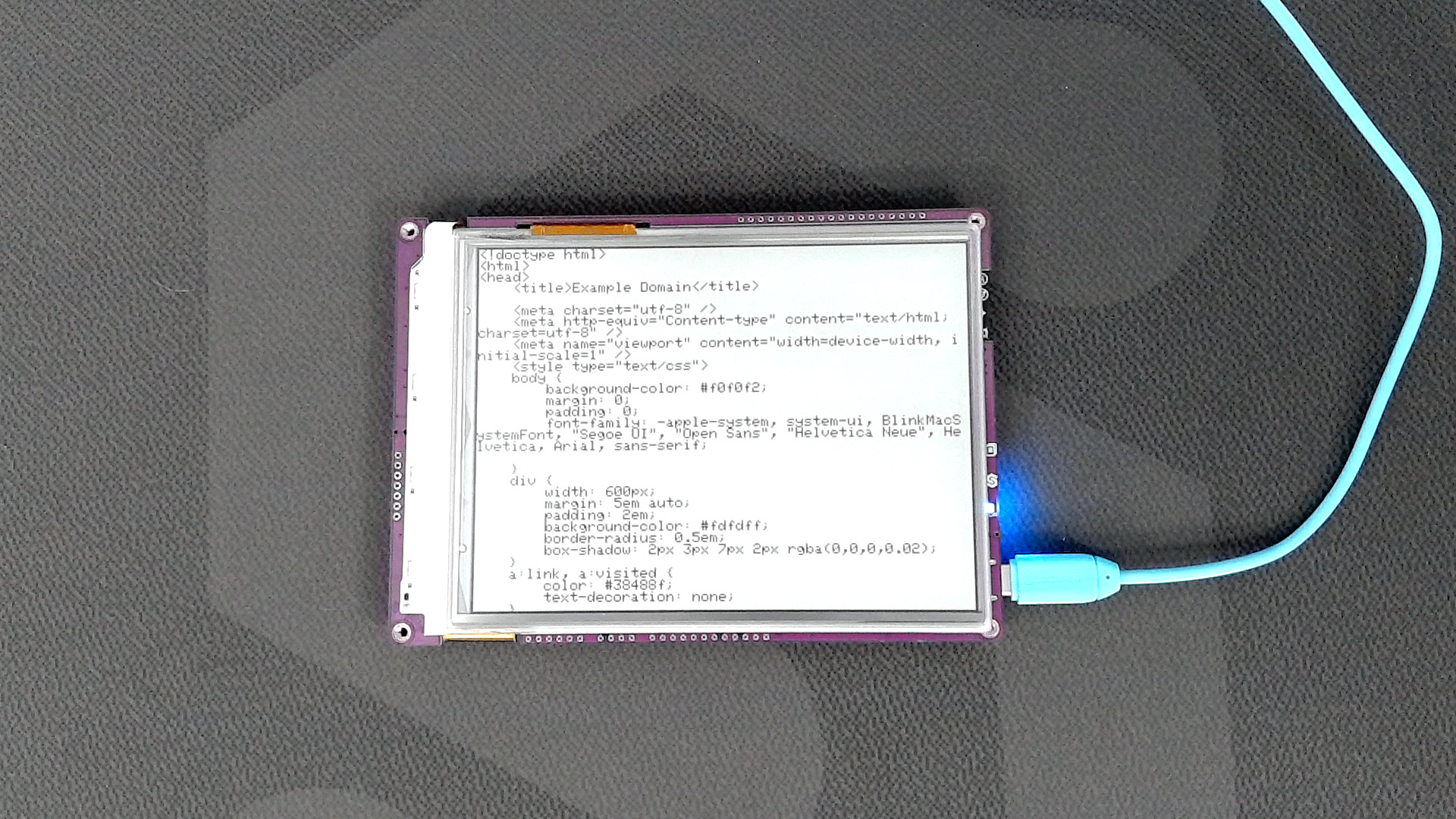

Using client.GET() will enable you to easily download and handle data on Inkplate however you want. Here is an example on how to GET an HTML file and print it on Inkplate:

HTTPClient http;
if (http.begin("http://example.com/index.html"))
{ // Now try to connect to some web page (in this example www.example.com. And yes, this is a valid Web page :))
if (http.GET() > 0)
{ // If connection was successful, try to read content of the Web page and display it on screen
String htmlText;
htmlText = http.getString();
display.setTextSize(1); // Set smaller text size, so everything can fit on screen
display.clearDisplay();
display.setCursor(0, 0);
display.print(htmlText);
display.display();
