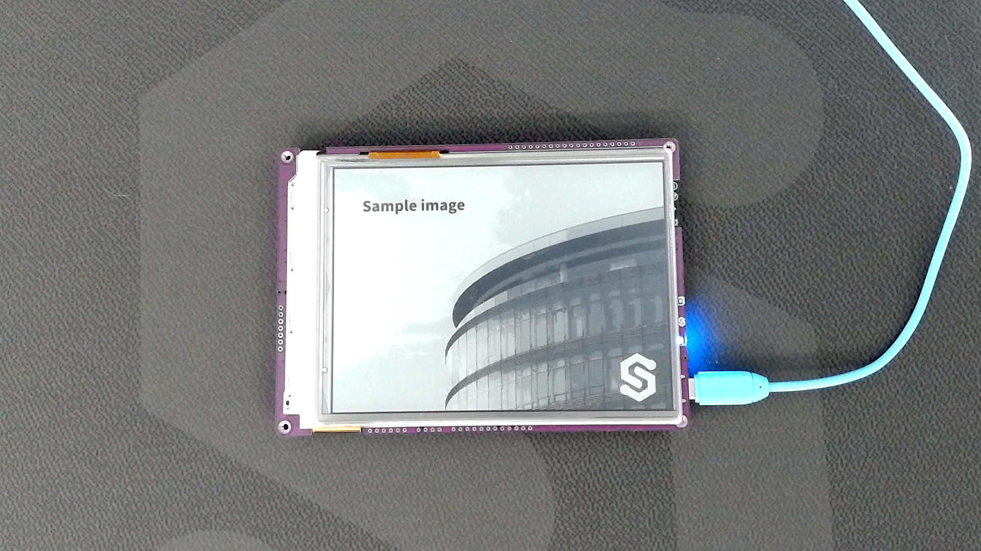

Let's draw this image of the Eurodom building in Osijek, Croatia, on Inkplate 6FLICK:
Example Image
Example image by @filipbaotic on Pexels
