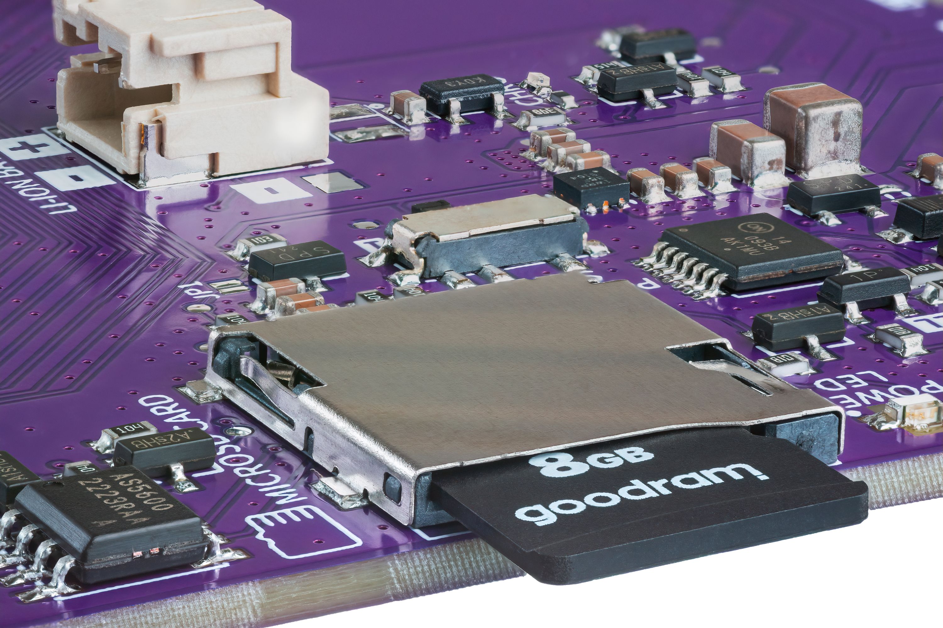

MicroSD card in Inkplate 6MOTION
8GB microSD card inserted in Inkplate 6MOTION
