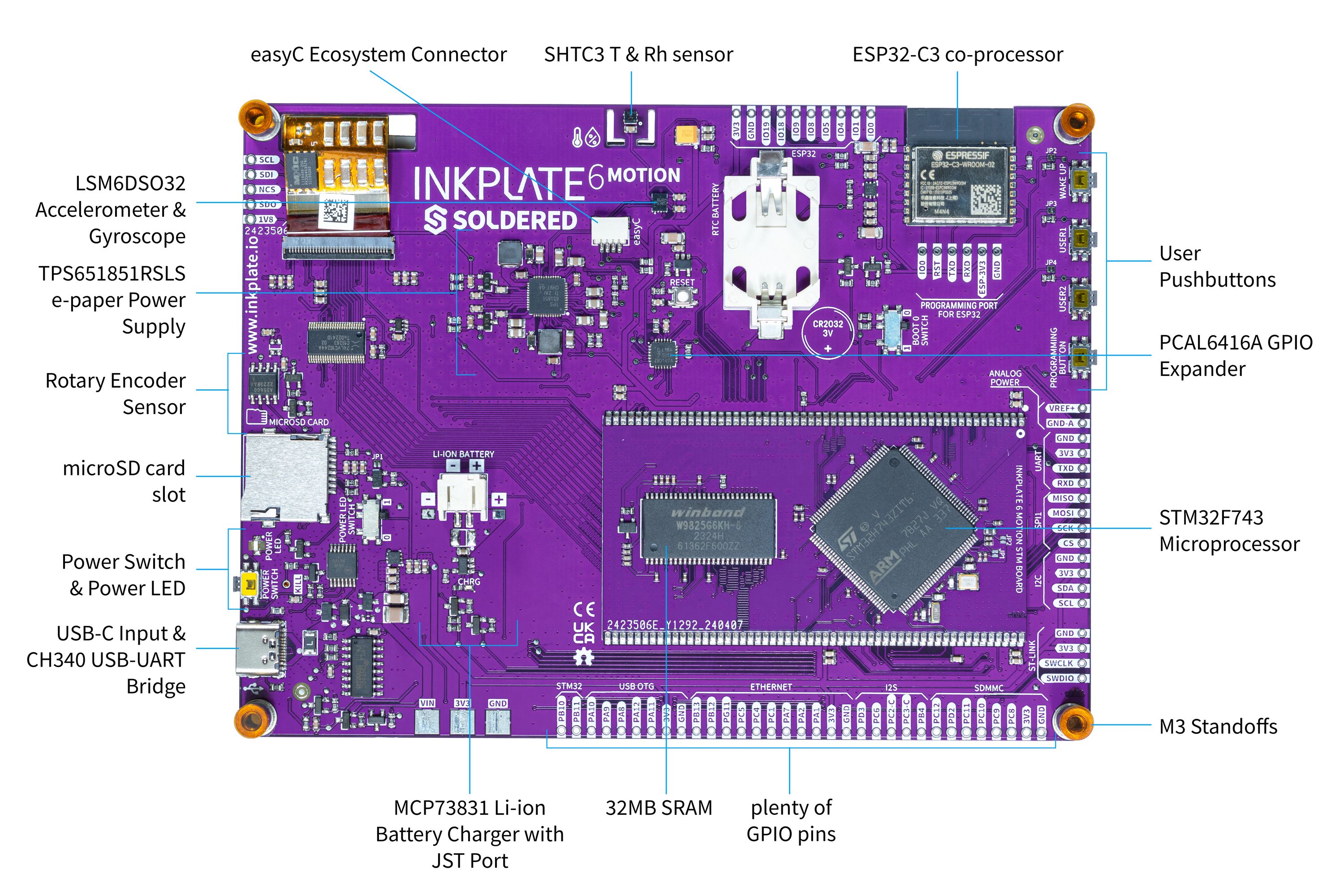

Inkplate 6MOTION's hardware consists of two separate board designs, each serving a distinct purpose.
The main board houses key components, including the e-Paper connectors, ESP32-C3 co-processor, microSD card slot, power switch, USB connector, and various supporting components. The STM32 board is dedicated to the STM32H743 microcontroller and external DRAM, ensuring precise timing and efficient memory management. This secondary board is referred to as the Inkplate 6MOTION STM board, as its main function is to break out the STM32's pins for connection to peripherals while maintaining stable communication with the DRAM.
STM32H743 on Inkplate 6MOTION
Inkplate 6MOTION back side
Inkplate 6MOTION, back side
What is referred to here as easyC is actually qwiic connectors

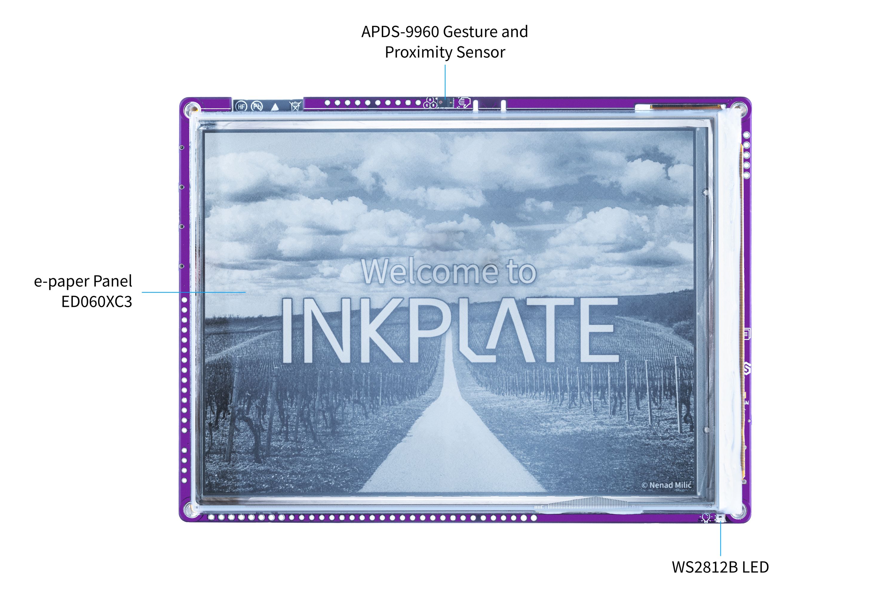

E-paper panel​
The ED060XC3 is a 6.0-inch e-paper display panel from E Ink Holdings Inc. This model is without a frontlight or touchscreen, making it ideal for low-power, high-contrast applications such as e-book readers.
It features a 758 × 1024 resolution (212 PPI), reflective matte treatment, and a 12:1 contrast ratio. The display operates in a 0°C to 50°C temperature range and can be stored in temperatures as low as -25°C.
See the table below for detailed specifications:
SpecificationDetails
BrandE Ink
Model NumberED060XC3
Diagonal Size6.0 inches
Resolution758 × 1024 pixels (212 PPI)
Pixel FormatRectangle
Active Area90.58 mm (W) × 122.368 mm (H)
Outline Dimensions101.8 mm (W) × 138.4 mm (H) × 1.68 mm (D)
Surface TreatmentAnti-glare
Contrast Ratio12:1 (Typ.) (Reflective)
Viewing AngleNot specified
Response TimeNot specified
Refresh Rate85Hz
TouchscreenNo (this version has no touchscreen)
BacklightNo backlight, no driver
Good Viewing ModeNot specified
Work ModeNot specified
Color DepthGrayscale
Mass50.0 ± 5.0 g
Use CaseE-Book Readers
InterfaceParallel Data (1ch, 8-bit), 34-pin FPC
Voltage Supply3.3V (Typ.)
Operating Temperature0°C to 50°C
Storage Temperature-25°C to 70°C
