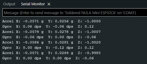

Serial monitor Accelerometer and gyroscope readings
Serial monitor Accelerometer and gyroscope output
