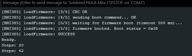

Serial monitor Step Counter readings
Serial monitor Step Counter output
