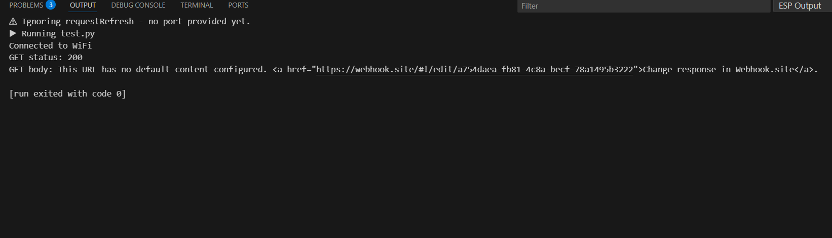

Inkplate 10 running the example code
Example code output.
