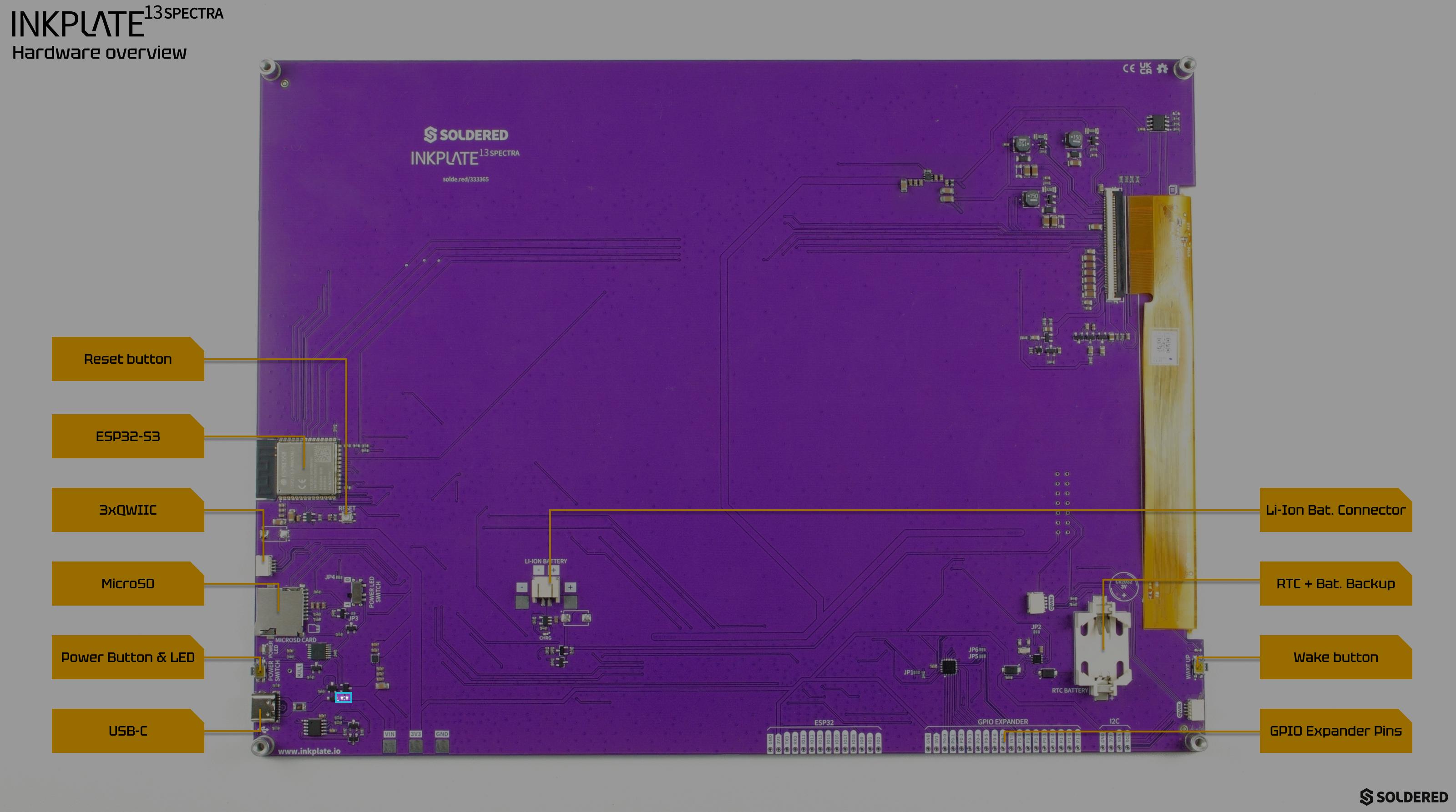

The Inkplate 13SPECTRA can be configured to power on automatically when current is present, bypassing the power switch.
R14 location
To bypass the power switch, simply short the R14 pads by directly adding a small amount of solder, or soldering a 0Ω resistor.
