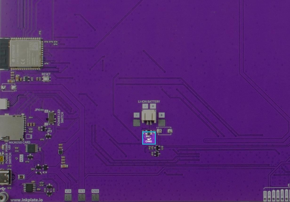

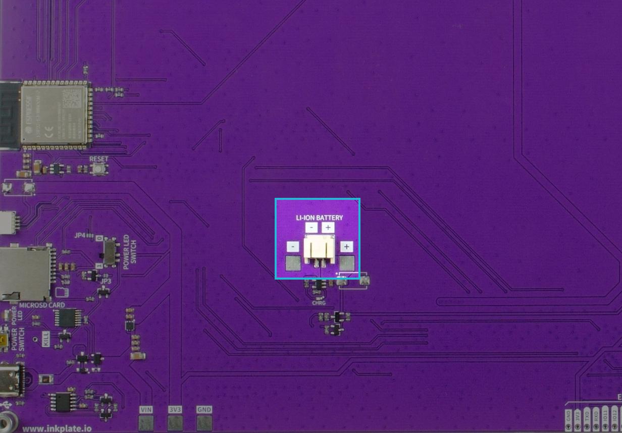

Inkplate 13SPECTRA includes a 2-pin 2mm JST connector, allowing you to connect a 3.7V Li-ion battery. The onboard charging IC, MCP73831, automatically charges the battery when Inkplate is plugged into USB-C and switches to battery power when unplugged. A charging indicator LED provides real-time charging status.
JST battery connector
Onboard charging indicator LED
Getting the battery polarity right matters. Check the markings on the PCB before connecting a battery. When orienting the JST connector with the notch at the top, the positive (+) terminal is on the right, and the negative (-) terminal is on the left.
Battery polarity can vary! Some Li-ion batteries have reversed polarity. Connecting a battery with the wrong polarity may permanently damage your Inkplate! Double-check before plugging it in.
