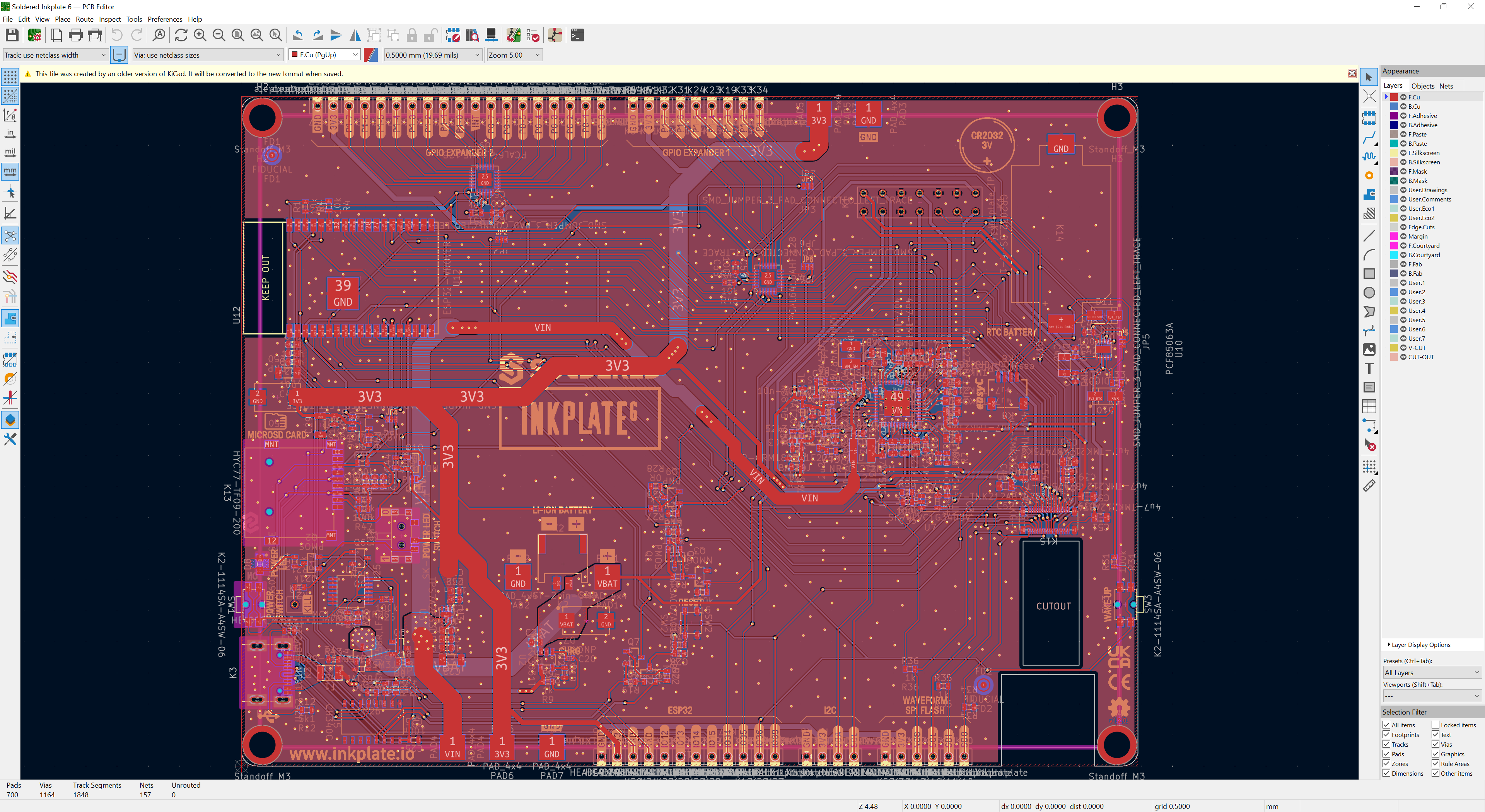

Inkplate 6 KiCad project

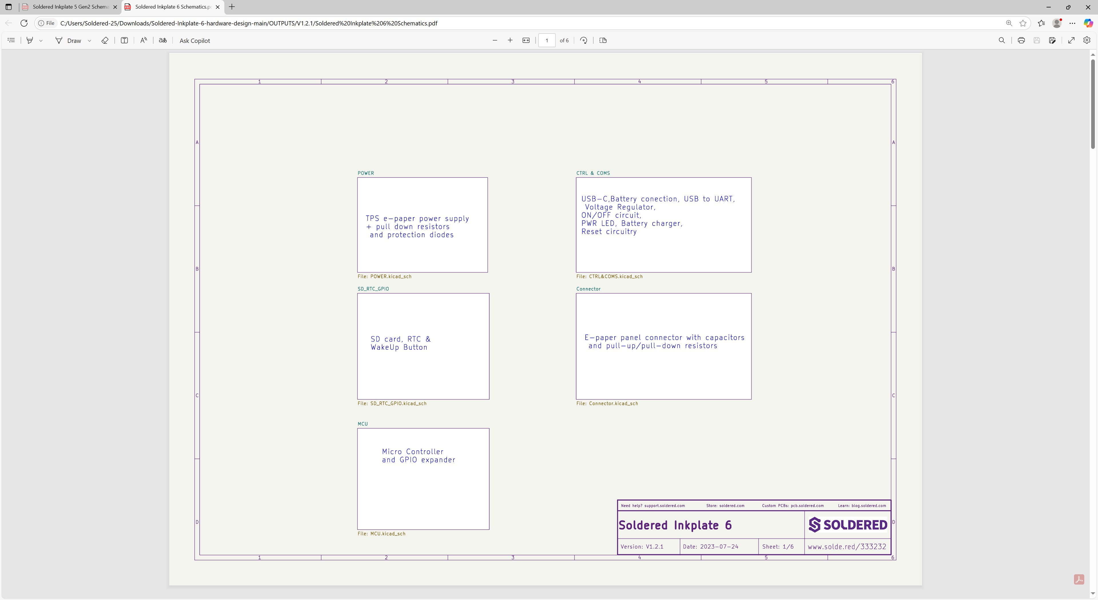

The OUTPUTS folder contains the schematic in .pdf format, exported from KiCad. The schematic is divided into sections based on functionality, making it easy to navigate.
Inkplate 6 schematic
Inkplate 6 schematic 1/6

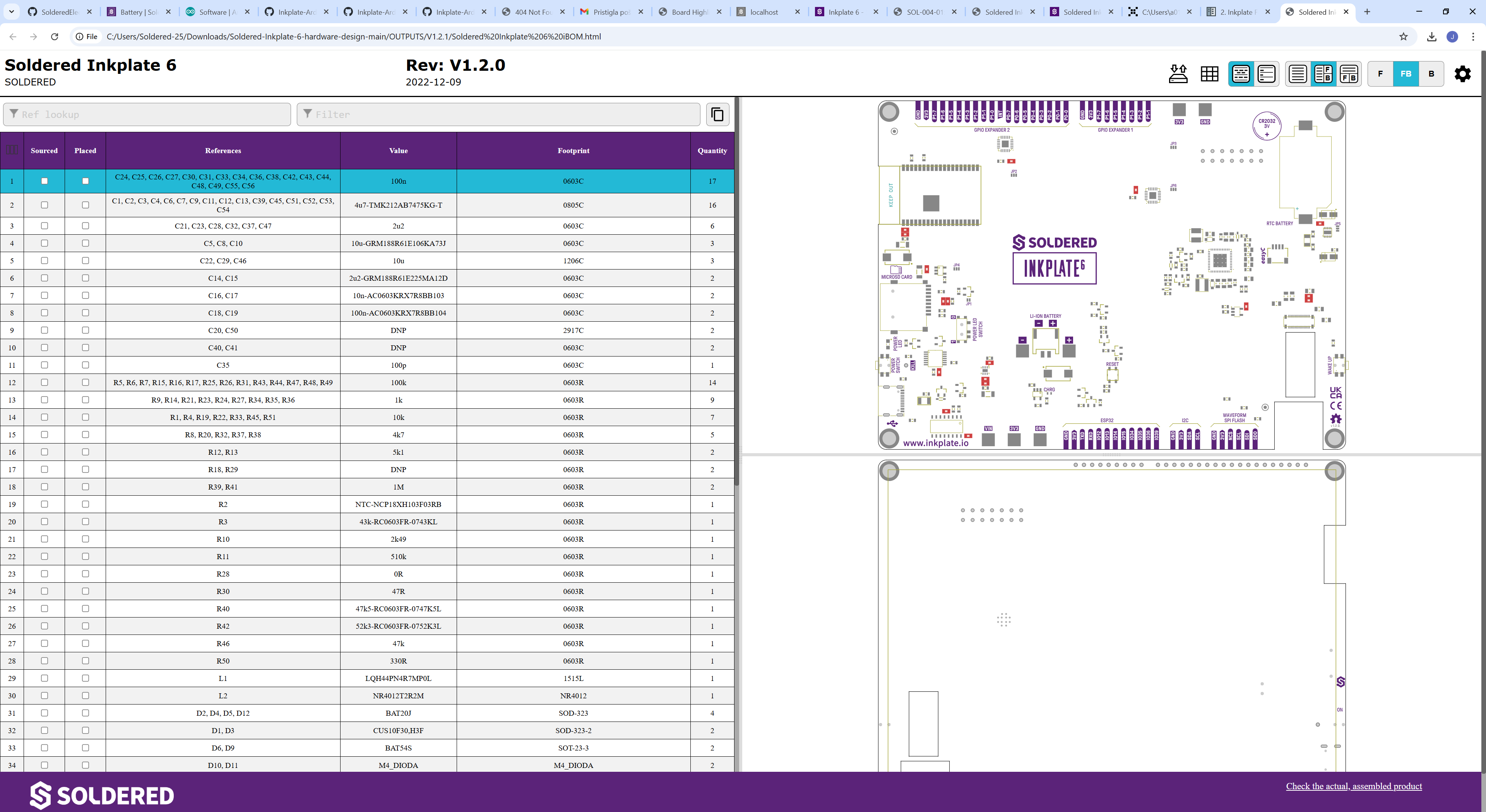

Inkplate 6 interactive BOM
Interactive BOM for Inkplate 6
