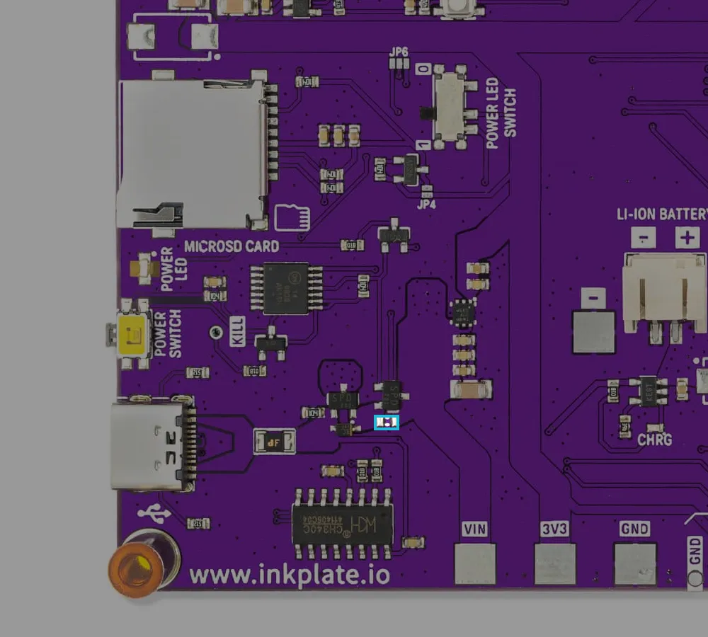

The Inkplate 6COLOR can be configured to power on automatically when current is present, bypassing the power switch.
To bypass the power switch, short the R16 pads with a small amount of solder, or fit a 0 ohm resistor. R16 is left unpopulated from the factory and sits directly across the switch, between SW_IN and VIN. The location of these pads is shown below:
Power switch location on Inkplate 6COLOR
R16 connection highlighted
