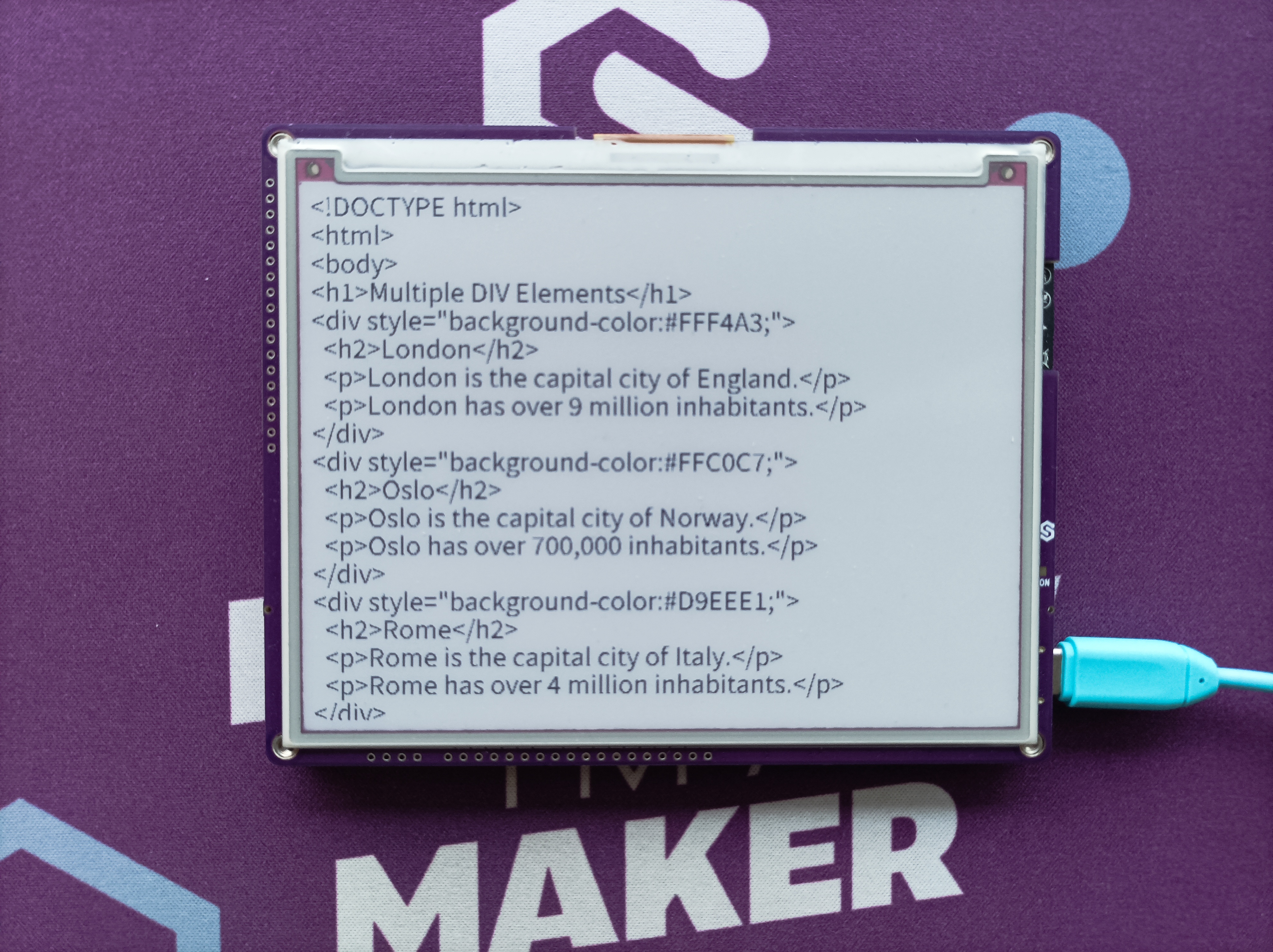

Use HTTP GET request to easily download and handle data on your Inkplate. This example shows how to use GET for .html file and print it on Inkplate.

GET Request example
Expected HTML output on display

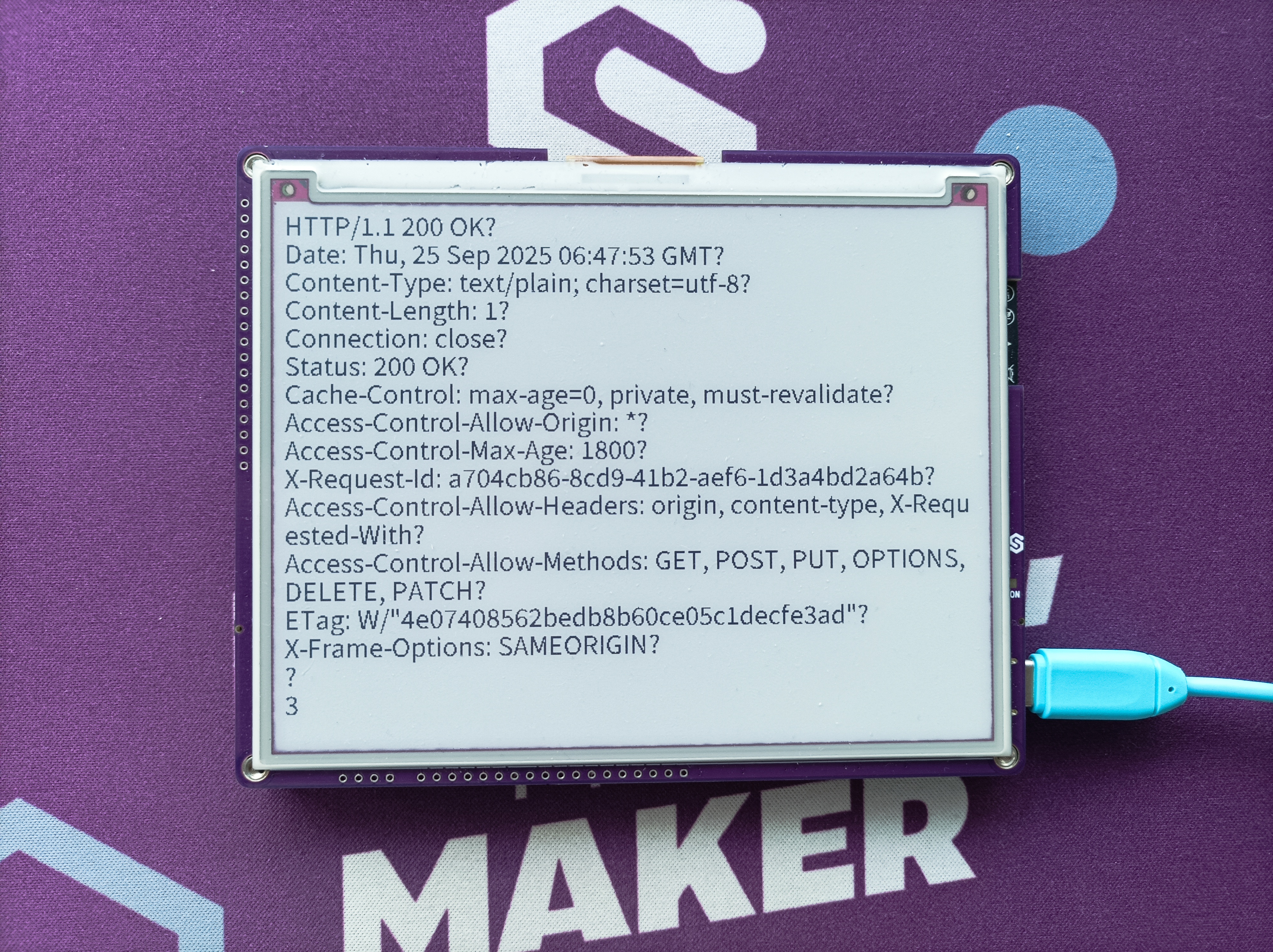

To send data from Inkplate to a web server we'll use ThingSpeak.com, which is a great free online IoT platform. To send data to ThingSpeak with a POST request, you need your channel's Write API Key. You can find this key under Channels tab in your account, opening the channel you created, and checking under the API Keys section. This key is used in your request when sending data.

POST example
Expected HTTP response output on display
