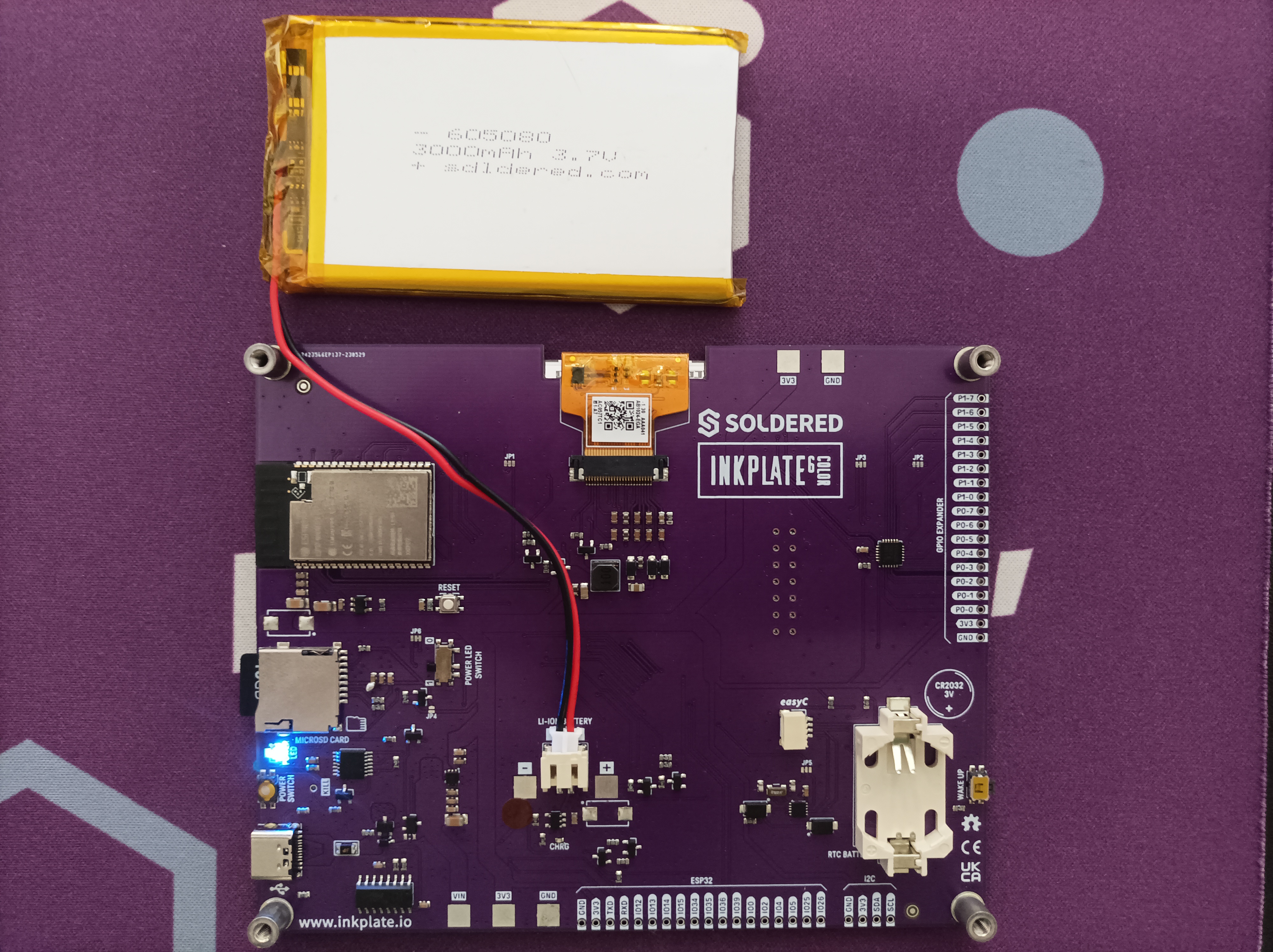

Battery connection
Battery connection
Connecting and using the battery correctly is important! Please refer to the battery usage page for guidance before use.

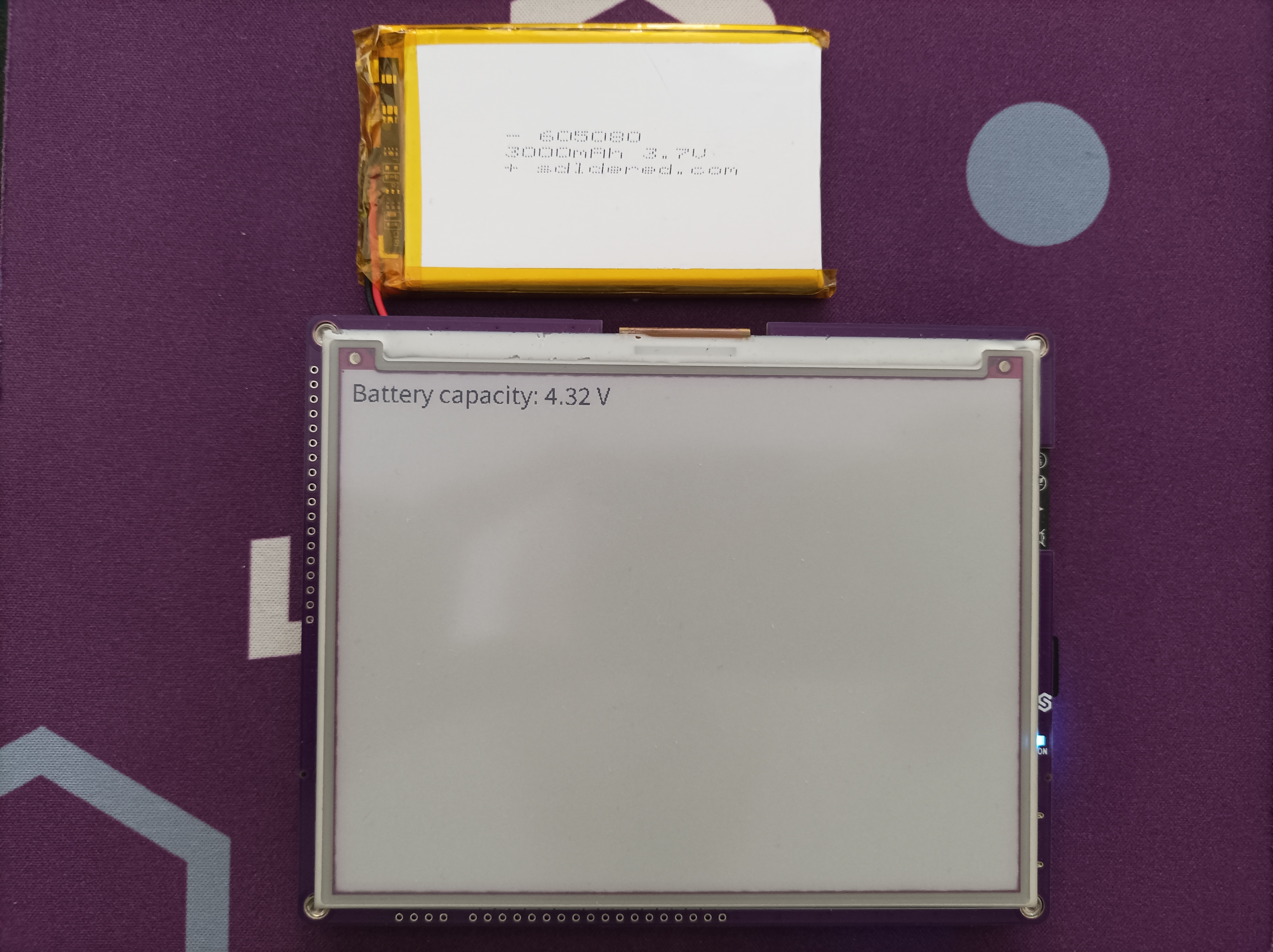

Battery info
Fully charged battery example
Expect about 4.2V on a full cell. 3.7V is the nominal voltage, so a reading there means the battery is roughly half used. Protected cells cut off near 3.0V.
