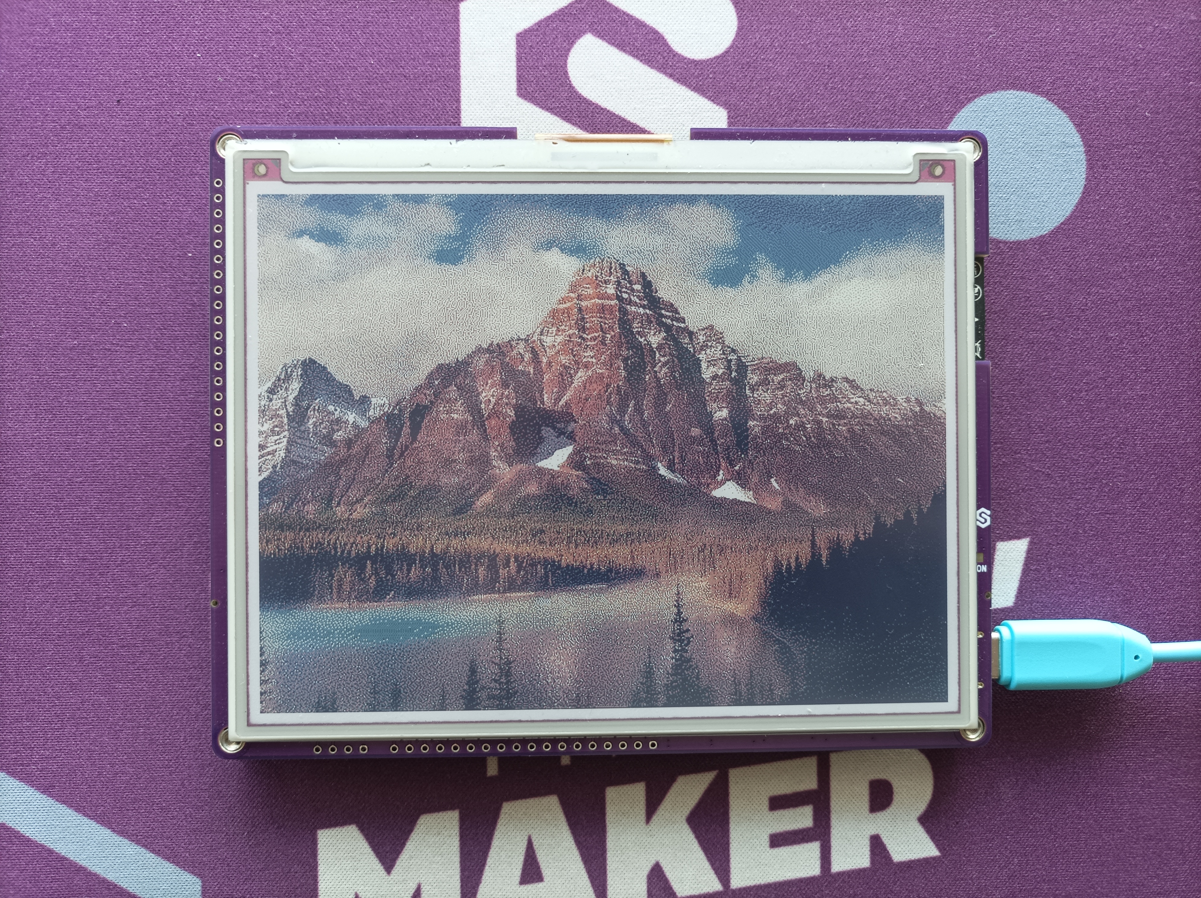

Example image displayed on Inkplate with Dithering enabled

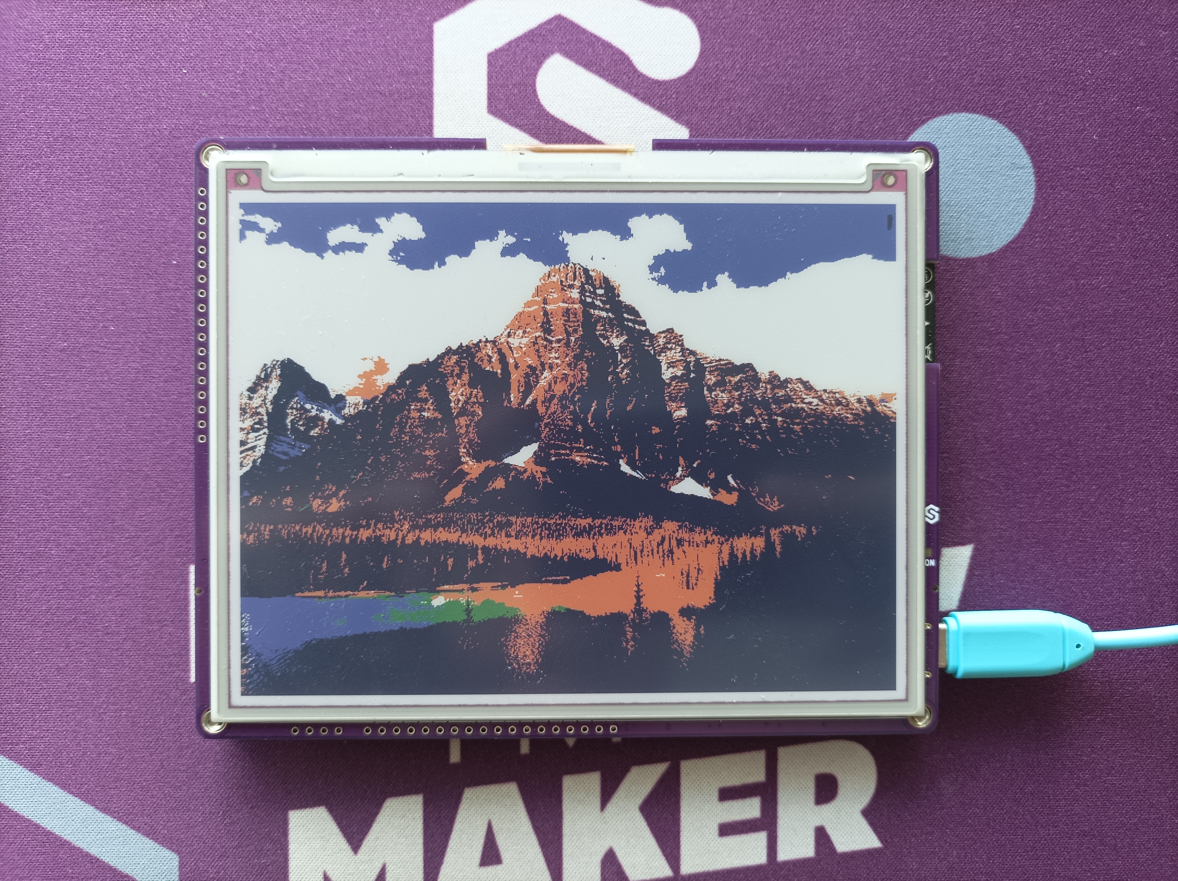

Example image displayed on Inkplate without Dithering
